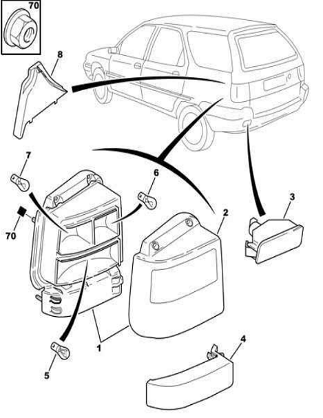

Just a tip - you will get better results looking for parts, using the Magneti Marelli part numbers as they are made by them. Those in the links have them in stock, but many of the searches I did for the Citroen Part Numbers were all out of stock / no longer available.
As for removing: Look at item 3 in the diagram below. To the left side of the lamp you can see a clip, so using a trim removal tool, you should be able to gently push in on the side of the clip and lever it out at an angle. Re-insertion should be a matter of putting the other side in at an angle and swinging the other side back into place. There are no official details I have on removing them, but I believe this is the correct way.

Re: Citroen ZX rear fog lens
Hi guys,
Have to tried get hold of the rear lights and can't, was refunded money from eBay because not in stock and have tried other online places where you can order it but then says stock unavailable or discontinued.
Anybody know anywhere abroad or anybody breaking a ZX estate or have seen one on a breakers recently?
There easy to remove by the way, spring clip on boot lid side push in and pull out.
Many thanks
Danny
