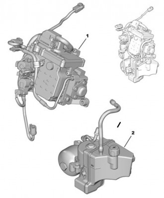

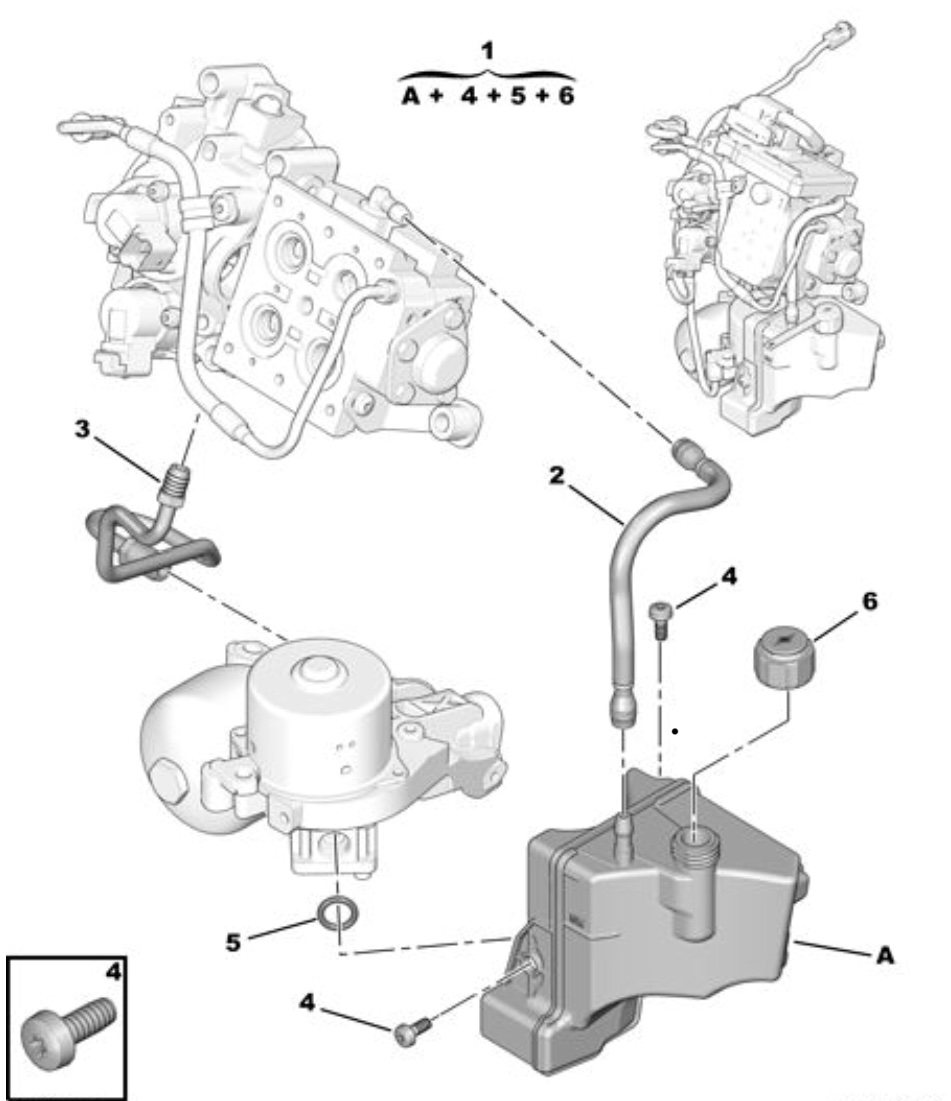

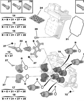

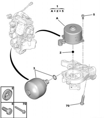

Ok so you have the STT6 speed manual gearbox.
Here are the main components of the system:
