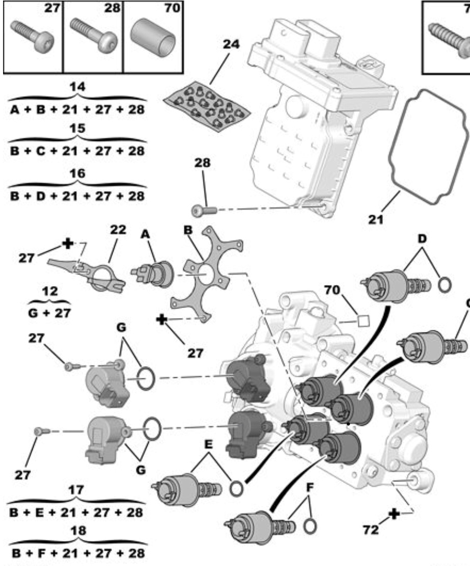

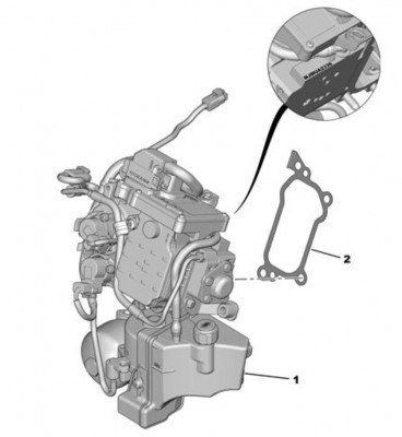

Ok so you have the STT6 speed manual gearbox.
Here are the main components of the system:
Another member changed out his clutch on his C4 Picasso with this system, and put up a load of his own videos on doing the job. It may help you get an idea of what’s involved generally...
viewtopic.php?f=3&t=61384&hilit=Chef
