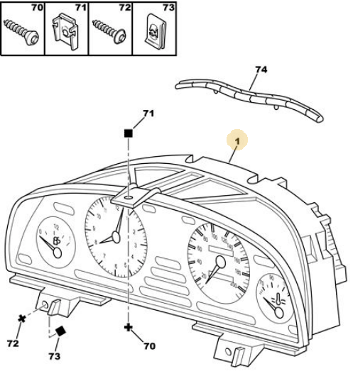

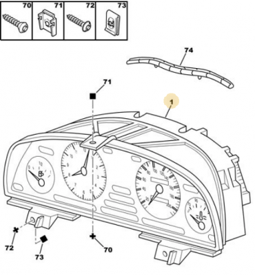

This should be your display:
Is the speedometer needle moving according to speed? Is the speedo needle intermittently failing or erratic? If it is then likely to be the speedo cable or either of the end connections possibly worn.

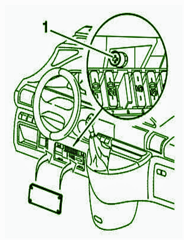

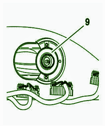

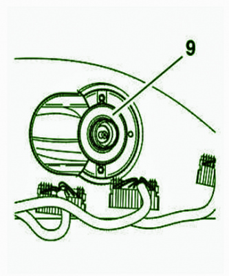

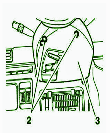

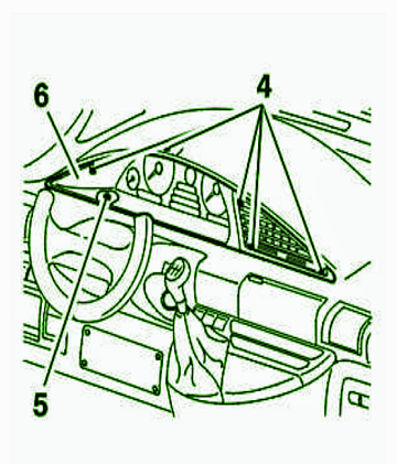

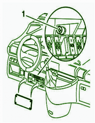

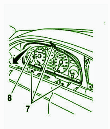

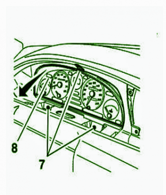

Here's how to remove it:
| Remove the fuse board access trap for access to the fixing (1). | Remove:
Remove the bottom cowl (3). |
Remove:
| Remove the mountings (7). |
Refitting N.B.: Check that the neck (9) which guides the speedometer cable is correctly positioned.
