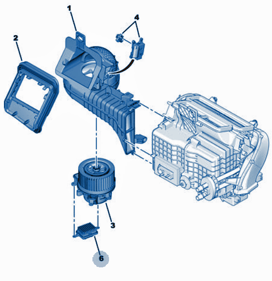

Well there seems to be an issue with the VIN I have from the registration - it is not being decoded by PSA's database. So when you do get home, do us a favour and double check it manually please then pop it up so I can compare it with the one returned. Very odd....
That aside, it seems on the DS5 that the control module for the fan is incorporated onto the actual motor as can be seen in the diagram:
It is item 6 and is part number: 6441CQ

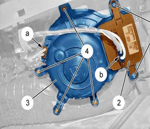

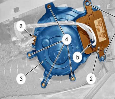

Re: DS5 Interior Blower dead
You'll probably need to get access to it by removing the lower console side trim
Ther are 2 bolts at (2) and the connector is shown at (a)

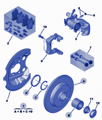

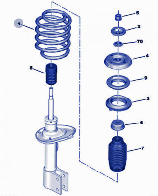

Ok! Thanks so much for the help, wondering if anyone could help with part numbers for my specific model, as its failed the MOT dramatically
Most of the faults are easily sorted, but theres so many variations on the parts I need Im a little stuck
My Reg is KU13 CKL, and I need a rear disc and a front coil spring. Any ideas where to go for the OEM part numbers?

Gaz83 wrote: 11 Mar 2019, 09:34 Ok! Thanks so much for the help, wondering if anyone could help with part numbers for my specific model, as its failed the MOT dramatically
My Reg is ******, and I need a rear disc and a front coil spring. Any ideas where to go for the OEM part numbers?
Ok, I have your VIN and I've masked your Reg number.
5002TK is the part number for your specific DS5 (Item 1) below. If you need any other parts on the diagram just shout.
The rear Discs are available in 2 versions - new original part, or new cheaper version. This is a kit (1) that contains A, B C & D
Original Part Number: 424946
Cheaper Part Number: 1619238880
