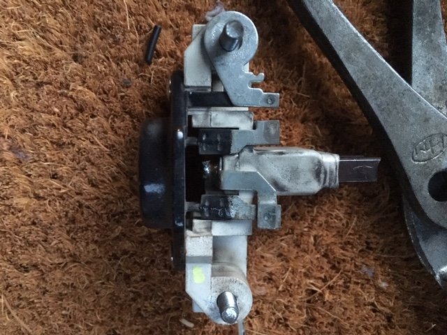

Have you actually dismantled the alternator to inspect the brushes? If not then you will have no real idea if the brushes ‘look ok’.

This one has a Bosch alternator, was able to take the end cap and brushes out without taking the alternator out. So yes, visually inspected.
Brushes
Brushes
I did disconnect all that I have done and no difference. After browsing other forums too, I found out info that if alternator stops working also the blower motor stops working. There hasn't been no sight of warning light earlier, but what exactly is a cutout voltage for that? Could the alternator have been bad earlier?
