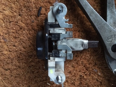

All the fuses have been checked as good. Alternator brushes look ok to me. Do I really have to go for a new alternator or am I missing something?

Have you actually dismantled the alternator to inspect the brushes? If not then you will have no real idea if the brushes ‘look ok’.

This one has a Bosch alternator, was able to take the end cap and brushes out without taking the alternator out. So yes, visually inspected.

Thank you very much for these replies, as of now alternator is without brushes for now. Will be able to get back to it on monday. But before that soaking all the info and looking for every info you can give to me.
