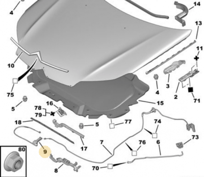

I had mine go 8 mths ago - the freezing weather at the time caused the plastic lever to snap (it's too brittle) and nearly failed the MOT as we couldn't open the bonnet. Had to do it with a screwdriver. Got the replacement - comes as a complete cable and plastic handle. What you need to hope is that it is the one at the bonnet end and not in the passenger compartment as that is a bu**er to do apparently.
Part 7937R0 for item 9: £24.56 inc. VAT from Citroen - called a Hook Plate.

Depends which cable it is - the easiest one is the actual bonnet release catch and cable which is attached and comes together. However the other cable (number 7 on the diagram I posted a few posts above) is the one from the inside passenger release lever to mechanism and that is a bit of a sod to do apparently.
