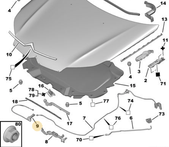

I had mine go 8 mths ago - the freezing weather at the time caused the plastic lever to snap (it's too brittle) and nearly failed the MOT as we couldn't open the bonnet. Had to do it with a screwdriver. Got the replacement - comes as a complete cable and plastic handle. What you need to hope is that it is the one at the bonnet end and not in the passenger compartment as that is a bu**er to do apparently.
Part 7937R0 for item 9: £24.56 inc. VAT from Citroen - called a Hook Plate.
I think we tried to use the screwdriver to lever the remaining part of the plastic tab containing the wire and manoeuvre it about to try and release it. You need to then remove the plastic shroud.

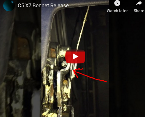

Not sure that this will help any, but the black lever holds one end of the wire in (which you can't see as it's underneath), and then with the black shroud removed (easy), the wire is routed through several clips, comes round in a U-turn and attaches into the spring release mechanism.
All that porridge in the mechanism is me having put copious amounts of Zinc marine-grade grease into the area and silicone oil onto and through the wires to protect them a little better. Any additional strain on the spring release mechanism doesn't bode well for the plastic lever as it is too flimsy to take any real strain - hence the need to keep it really well lubricated.

OK latest update using piece of garden wire and the very helpful video above I got the bonnet open!! HURRAH!
The cable had come away at the catch end seems like the horrible plastic clip had worn and was just drawn through. Greased cable, pushed clip back into position and have applied a dollop Araldite to hold in place, willgive it overnight to see if it will hold! Picture attached of the piece that came away!

Depends which cable it is - the easiest one is the actual bonnet release catch and cable which is attached and comes together. However the other cable (number 7 on the diagram I posted a few posts above) is the one from the inside passenger release lever to mechanism and that is a bit of a sod to do apparently.

? Not sure what you mean...handed
As long as you can release the lock from the inside first, you should be able to carefully get a long screwdriver in and lever the catch / wire. That's what my mechanic and I had to do when I had to drive it to pick up the new part and for the MOT, until I got it home again and replaced it.
