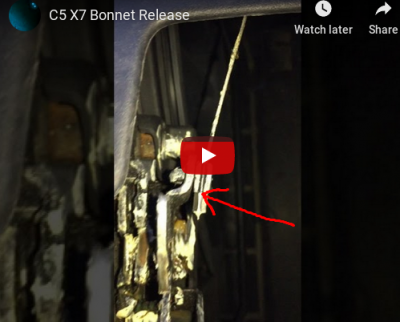

I'll pop a little video up of mine as soon as I've uploaded it.

Not sure that this will help any, but the black lever holds one end of the wire in (which you can't see as it's underneath), and then with the black shroud removed (easy), the wire is routed through several clips, comes round in a U-turn and attaches into the spring release mechanism.
All that porridge in the mechanism is me having put copious amounts of Zinc marine-grade grease into the area and silicone oil onto and through the wires to protect them a little better. Any additional strain on the spring release mechanism doesn't bode well for the plastic lever as it is too flimsy to take any real strain - hence the need to keep it really well lubricated.

OK latest update using piece of garden wire and the very helpful video above I got the bonnet open!! HURRAH!
The cable had come away at the catch end seems like the horrible plastic clip had worn and was just drawn through. Greased cable, pushed clip back into position and have applied a dollop Araldite to hold in place, willgive it overnight to see if it will hold! Picture attached of the piece that came away!

My lever broke a few days ago, so now I can only life the bonnet a few inches. Any tips as to access the latch to operate it manually? I see the video above is handed, but otherwise very useful!
x 6961
Re: C5 m3 bonnet catch wont release fully
handed
? Not sure what you mean...
As long as you can release the lock from the inside first, you should be able to carefully get a long screwdriver in and lever the catch / wire. That's what my mechanic and I had to do when I had to drive it to pick up the new part and for the MOT, until I got it home again and replaced it.
