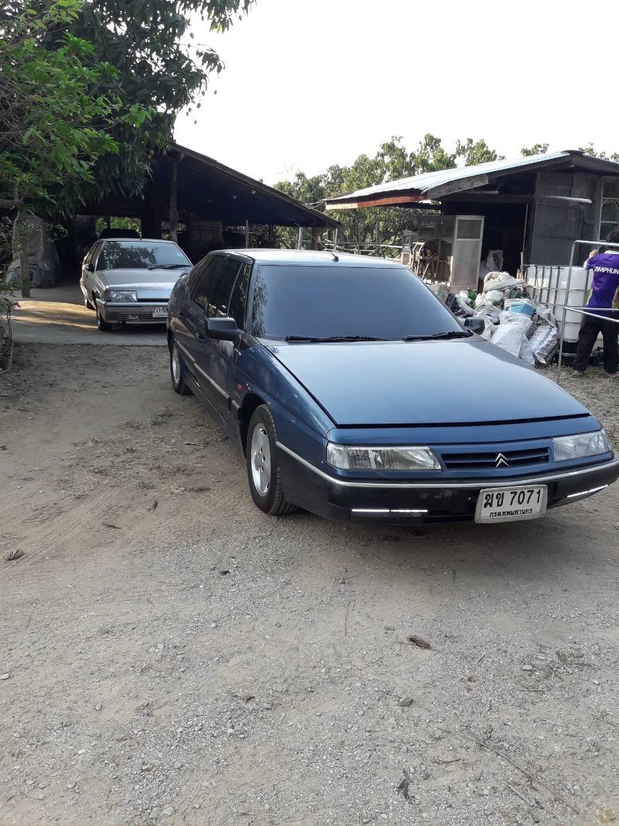

I have just learned that someone living only 40 minutes from me has an XM for sale. It's been described as a Turbo - see photograph.
You now know as much about it as I do.
This is where I need your help - without knowing if it's Benzine (Thai word for non ethanol petrol) or diesel, without knowing what engine or what level of trim, what should I be looking for both + and - ?
From the photo it seems in reasonable shape - but we don't know how recent the photo, do we? It is not unusual in Thailand to photograph the car on delivery and use those pics when it comes to sale time.
Just a few pointers would be helpful what are the usual weak points, what should I look or listen for type of thing.
I'm pretty good at kicking tyres, which I've often found marks me as a person of sound judgement, anything more helpful than that would be appreciated! :-D

Judging by the mirrors and trim, I think that it is probably a mid-spec (SX) late Mk1 XM (year 92 or 93), it is often very difficult to determine the specification of an XM just from a photo. It could be a 2.0 CT petrol or a 2.1 TD diesel.
Spare parts for and XM are not so easy to find, but in the 5 years I have owned mine, I have not needed to fit anything other than normal service items.

It looks like it has a Series 2 nosecone, but some Series 1 other bits. Could be a transitional model (so-called Series 1.5) from c.1994.

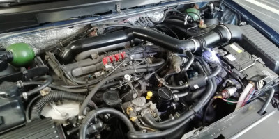

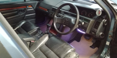

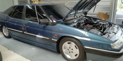

UPDATE
We are 7 hours ahead of UK so when I went to see the XM this morning it was still dark at your end.
It's a Automatic 2.0 Turbo C.T. - Version 1.5 with a 2 grill stuck on the front ( a PO preferred and changed it in the late 90s) - See pics.
Positives - Current owner knows what he's talking about, his is not his only Citroen. No Rust, everything works Electrics, suspension, starts first turn of the key & I like the quirkiness of the interior. Maintenance and repairs been well done, a rare thing in the Land of Smiles and all faulty units replaced.
Done a genuine 110k Kilometres. LMH clear as crystal, new tyres, recent service. Spheres replaced 3 years ago
Negatives - O/S Front Wing, Bonnet and Roof need a respray., Front leather seats need recovering, Glove Box 'knob' broken, need to remove film from windscreen. Road tax not paid for the last couple of years.
Changed the radio so no steering wheel controls. Remote locking long gone.

FORGOT TO MENTION
So it's an 8 valve engine!
It is also fitted with LPG so there's a large tank in the boot which will need changing to a donut.

Good luck with the negotiations. I think that the amount that you have offered is OK, you wont find a well-maintained, rust free RHD example in the UK any cheaper (or at all).

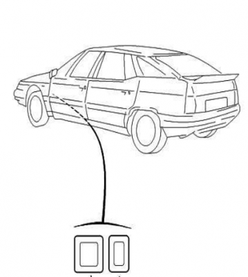

If you want the ORGA, I’ll need the VIN and for the specs,as I mentioned earlier. (Lower left outler windscreen)
x 1751
Re: Help Please - I'm going to see an XM tomorrow
XM VIN is in a cut-out on top of the front right inner wing.
Do do a test drive of that auto box, both cold and well warmed up.
4-digit ORGA (RP) number between the hinges on front left door.
x 6957
Of course, force of habit #-o - the XM VIN location is different:
