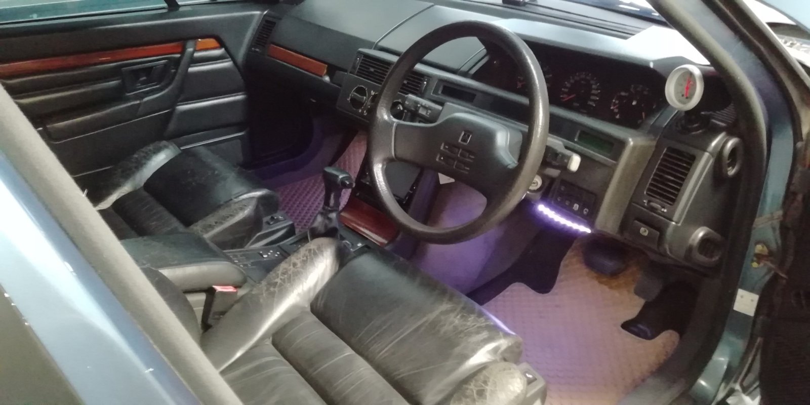

I have just learned that someone living only 40 minutes from me has an XM for sale. It's been described as a Turbo - see photograph.
You now know as much about it as I do.
This is where I need your help - without knowing if it's Benzine (Thai word for non ethanol petrol) or diesel, without knowing what engine or what level of trim, what should I be looking for both + and - ?
From the photo it seems in reasonable shape - but we don't know how recent the photo, do we? It is not unusual in Thailand to photograph the car on delivery and use those pics when it comes to sale time.
Just a few pointers would be helpful what are the usual weak points, what should I look or listen for type of thing.
I'm pretty good at kicking tyres, which I've often found marks me as a person of sound judgement, anything more helpful than that would be appreciated!

Judging by the mirrors and trim, I think that it is probably a mid-spec (SX) late Mk1 XM (year 92 or 93), it is often very difficult to determine the specification of an XM just from a photo. It could be a 2.0 CT petrol or a 2.1 TD diesel.
Spare parts for and XM are not so easy to find, but in the 5 years I have owned mine, I have not needed to fit anything other than normal service items.

UPDATE
We are 7 hours ahead of UK so when I went to see the XM this morning it was still dark at your end.
It's a Automatic 2.0 Turbo C.T. - Version 1.5 with a 2 grill stuck on the front ( a PO preferred and changed it in the late 90s) - See pics.
Positives - Current owner knows what he's talking about, his is not his only Citroen. No Rust, everything works Electrics, suspension, starts first turn of the key & I like the quirkiness of the interior. Maintenance and repairs been well done, a rare thing in the Land of Smiles and all faulty units replaced.
Done a genuine 110k Kilometres. LMH clear as crystal, new tyres, recent service. Spheres replaced 3 years ago
Negatives - O/S Front Wing, Bonnet and Roof need a respray., Front leather seats need recovering, Glove Box 'knob' broken, need to remove film from windscreen. Road tax not paid for the last couple of years.
Changed the radio so no steering wheel controls. Remote locking long gone.
CURRENT STATUS
We left on good terms I offered him 70,000 THB - £1702.41 at today's Brexit rate. This may seem excessive, but is way below the owners expectations and current values here. He will consider and let me know.
If he rings then I know he has agreed, if someone else rings to discuss then my offer has not been accepted (a bit of local negotiating technique here, all to do with 'face' and harmony
CONCLUSION and Responses
Thank you for all the helpful advice and concern, for those who raised the spares situation - if Thailand's Classic Car owners were to depend on local stocks there would be no classic cars. I am told there is no Thai word for planning, likewise I doubt there is one that is understood for maintenance. This does not lead to agents and distributors holding vast stocks of components. When they do something happens to prices!
I have just decided to replace the 3 spheres in y Xantia, having picked the brains of this forum I knew what to order and got a price from the Main Dealer in Bangkok. I bought them from UK over the internet, paid shipping and import duty and had a bill of exactly one third of that I was quoted locally.
I made a list of those points that you all were kind enough to offer and checked everything out, with one notable exception - no test run! If my price is accepted then we will test drive to my friend the mechanic's workshop and he will give it a final check over for me. If the price is not accepted than it wasn't worth the effort of getting the thing out of the shed where it is stored. A minor thing I forget was to check out ORGA number and the paint colour - anyone know what t is?
