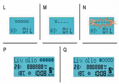

Base version instrument panel:
L: Maximum engine oil level indication (trim level 5)
M: First engine oil level indication
N: Minimum engine oil level indication (Flashing dashes)
Comfort version instrument panel:
P: Maximum engine oil level indication (trim level 5)
Q: First engine oil level indication

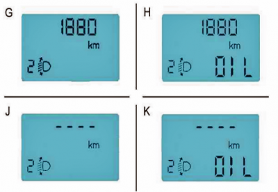

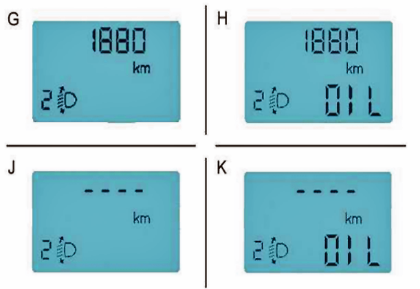

Another example of the Base Display Unit:
G: Indication of the distance remaining before the scheduled service is due
H: Indication of the distance remaining before the engine oil change is due
J: Indication that the scheduled service is overdue
K: Indication that the engine oil change is overdue
