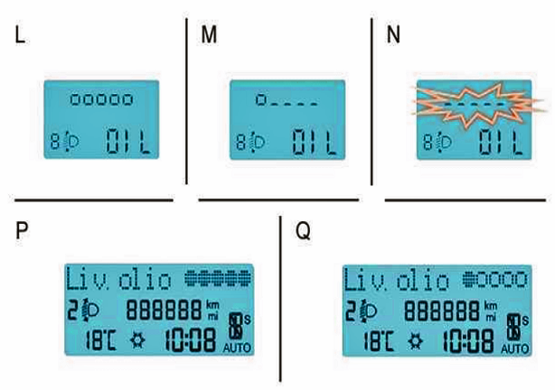

So here are the displays and meanings - if it is the dashes that you are concerned about. Note the following in bold - this can indicate when the oil is due a change not just the level.
When the ignition is switched on and if necessary, the indications of when a scheduled service is due and of when an engine oil change is due are each displayed for 5 seconds in the following order :
Threshold at which a scheduled service is due
Threshold at which an engine oil change is due
Base version instrument panel:
L: Maximum engine oil level indication (trim level 5)
M: First engine oil level indication
N: Minimum engine oil level indication (Flashing dashes)
Comfort version instrument panel:
P: Maximum engine oil level indication (trim level 5)
Q: First engine oil level indication
Another example of the Base Display Unit:
G: Indication of the distance remaining before the scheduled service is due
H: Indication of the distance remaining before the engine oil change is due
J: Indication that the scheduled service is overdue
K: Indication that the engine oil change is overdue
