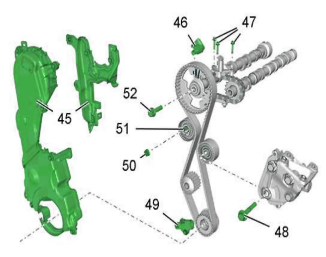

ReferenceDesignationTightening Torque
(45)Bolts (Timing Cover)0,5 daNm
(46)Bolts (Cylinder Reference Sensor )0,6 daNm
(47)Bolts (Timing Chain Tensioner)0,6 daNm
(48)Bolts (Roller Tensioner )5,7 daNm
(49)Bolts (Engine Speed Sensor)0,7 daNm
(50)Nut (Roller Tensioner ) (Timing Gear)2,1 daNm
(51)Stud (Roller Tensioner ) (Timing Gear)1 daNm
(52)Bolts (Camshaft Pulley )Pre-tighten to 2 daNm
Angular tightening to 60°

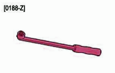

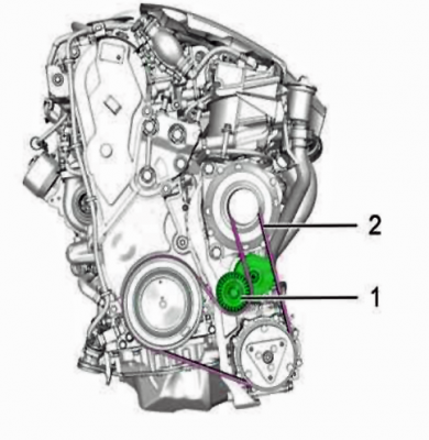

CAUTION: Mark the direction of fitting of the ancillary drive belt if it is to be reused.
Fit the tool [0188-Z] on the dynamic tensioner bolt (1).
Detension the ancillary drive belt (2); Using tool [0188-Z].
Peg by means of tool [0188-Q1] (at "a").
Remove:
The tool [0188-Z]
The accessories drive belt (2)

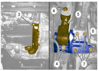

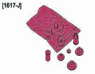

During removal: Plug the fuel low pressure supply pipes; Using the plugs [1617-J].
  • Uncouple the unions of the fuel low pressure circuit (at "a").
  • Unclip and move aside the manual priming pump (1).
  • Remove the mounting of the diesel fuel manual primer pump (2) ; By means of a screwdriver (at "b").
Remove the air union (3)
CAUTION: Use a rubber shim of sufficient surface area to avoid distorting the engine oil sump (Risk of obstruction of the oil pump suction strainer.)
Support the engine using a jack and a soft block (Timing gear side).
Remove:
  • The mountings (4)
  • The bolts (7)
  • The engine supports (5) and (6)

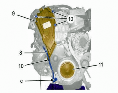

Disconnect the connector of the engine speed sensor (at "c").
Release and move aside the electrical harness (8).
Remove:
  • The pulley cover (11)
  • The bolts (10)
  • The top timing cover (9)

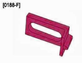

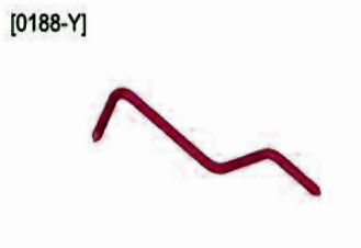

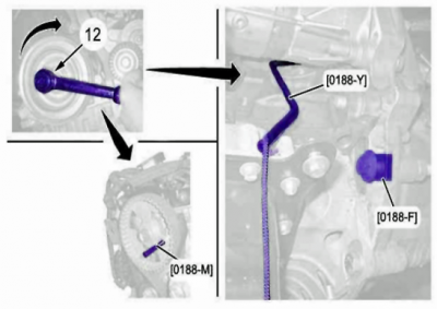

CAUTION: It is essential to rotate the engine by means of the bolt (12) and in the clockwise direction only.
Peg:
  • The camshaft pulley ; Using tool [0188-M]
  • The flywheel ; Using tool [0188-Y]
Lock the flywheel using the retainer [0188-F].

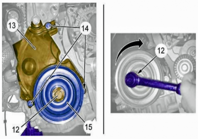

CAUTION: The target (16) must show no trace of damage and no magnetic source must go near it.
CAUTION: Use of an impact wrench is prohibited (Risk of the bolt (12) breaking in the crankshaft)
Remove:
  • The bolt (12) and its spacer
  • The crankshaft pulley (15)
  • The engine speed sensor target (16)
  • The 3 bolts (14)
  • The timing cover (13)
Clean the crankshaft thread with a M14x150 thread cutter.

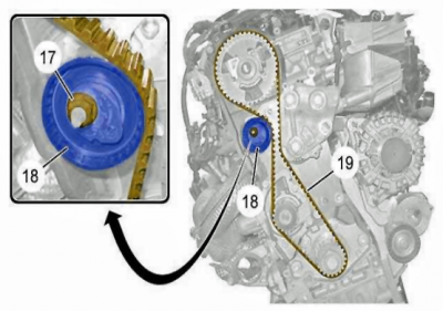

Unscrew nut (17).
Detension the dynamic tensioner roller (18).
Remove the timing belt (19).

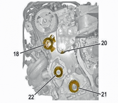

Verification
Check that the following components rotate freely (Absence of play and points of resistance):
  • Dynamic roller tensioner (18)
  • Roller tensioner (20)
  • Crankshaft pulley (21) on keyways
  • Water pump pulley (22)

Dynamic Roller Tensioner
CAUTION: The operations for replacing and adjusting the tension of the dynamic tensioner roller (18) are performed with the aid of a mirror.
Replacement
CAUTION: Do not release the new dynamic tensioner roller (18) without having refitted the timing belt (19).
Remove:
  • The nut (17)
  • The stud (23)
  • The dynamic roller tensioner (18)

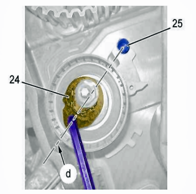

CAUTION: The dynamic tensioner roller (18) should be secured in the cylindrical pin (25).
Refit:
  • The dynamic roller tensioner (18) (new) (Locked)
  • The stud (23)
  • The nut (17) ; Finger tighten
  • Align the eccentric (24) on the axis "d" ; Using a hexagonal spanner
If Re-Used:
Align the eccentric (24) on the axis "d" ; Using a hexagonal spanner.

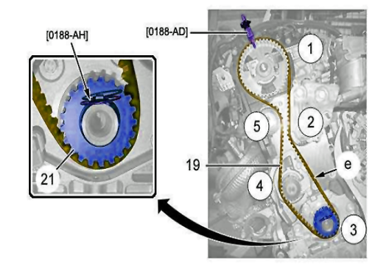

Pre-Tightening The Belt
CAUTION: Always replace the timing belt (19).

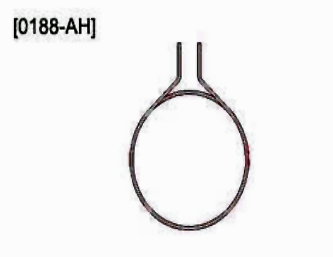

  • Rotate the crankshaft pulley (21) on its cotter pin; Centre using the tool [0188-AH].
  • Fit the timing belt (19) on the camshaft pinion ; Immobilise the pinion ; Using tool [0188-AD].
  • Position the timing belt (19) on the pulleys in the order indicated ; Span ("e") of the belt correctly tensioned.
CAUTION: New dynamic roller tensioner (18): Take away the locking pin.

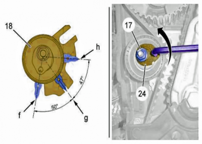

Position of the indexState of tension of the timing belt
"f"Dynamic roller tensioner (18) at maximum timing belt tension
"g"Dynamic roller tensioner (18) at nominal timing belt tension
"h"Dynamic roller tensioner (18) at minimum timing belt tension
Apply a maximum tension to the timing belt (19):
  • Do up the nut (17) by hand
  • Rotate the eccentric (24) anti-clockwise
  • Bring the index to position "f"
  • Tighten the nut (17)
N.B. : The eccentric (24) is close to the horizontal.
Remove the tools [0188-AD], [0188-AH].
CAUTION: Systematically replace the screw (12); Do not go beyond 5 minutes between pre-tightening and final tightening of the bolt .
Refit:
  • The 3 bolts (14)
Remove the tools [0188-F], [0188-M], [0188-Y].
Turn the engine 6 rotations in the clockwise direction.
Check the position of the timing belt (19).
Peg the assembly with tools [0188-F], [0188-M], [0188-Y].
Slacken the bolt (12) in order to permit the crankshaft pulley to rotate on its keyways.

Final Tension
CAUTION: When detensioning the dynamic tensioner roller, do not go past the index "g". Otherwise, you must restart the pretensioning operation.
Apply a nominal tension to the timing belt:
  • Slacken the nut (17) while maintaining the eccentric (24) in position
  • Slowly rotate the eccentric (24) in the clockwise direction
  • Bring the index to position "g"
  • Tighten to the specified torque: The nut (17)

Refit the pulley cover (11) ; Using rubber lubricant
CAUTION: Check the correct positioning of the pulley cover by pulling gently on the lip.
Refit:
  • The bolts (10)
Clip the electrical harness (8).
Connect the connector of the engine speed sensor (at "c").
  • The mountings (4)
  • The bolts (7)
  • The air union (3)
  • Remove the diesel fuel manual priming pump support (2) ; By means of a screwdriver (at "b")
  • The manual diesel priming pump (1)
