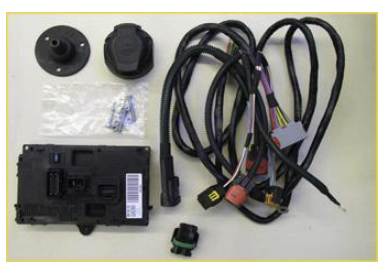

Ok, so this is the recommended harness. It contains the BSR EV unit (trailer module unit that will talk to the BSI and ABS / ESP system)
Info:
  • Compatible on all the vehicles from start of series; To fit the fuse, consult the additional doc; Harness fitted with a BSR EV; Non-Contractual Photo.
Description
  • Harness supplied with:
  • 1 x 13-pin socket plus fixings;
  • 1 fitting instructions;
  • 1 BSR EV.
Technical Characteristics:
  • Always follow the manufacturer’s instructions and especially the tightening torques indicated in the installation manual.
  • It is essential that the jack be removed from its housing in the spare wheel to be stored in the boot.
  • This harness takes account of the features of the vehicle, thus ensuring safety, reliability and simplicity of fitting.
  • Simple connection using the interface connectors identical to those for the vehicle.
These are the related parts numbers / options that are compatible:
9427 AC: SWAN’S NECK TOWING BALL
9427 AF: TOW BAR WITH TOW BALL THAT CAN BE REMOVED WITHOUT TOOLS
9453 13: (ACC) CARAVAN REAR VIEW MIRROR
Part No: 16062177 80 and costs £126.85 from Citroen inc. VAT.
They recon it is 2.5 Hours to fit the harness (by their estimations)

So the 9428.67 isn't the right one
And the one in the picture 16062177 80 is the right one
If am reading right
x 6963
Re: C4gp 08 towing kit
That's correct - the 942867 is not listed under any part or accessory for your specific C4 Picasso. :-D

The proper one should automatically deactivate rear parking sensors and tell the ABS/ESP ECU that you are towing, so that it can implement a special stability programme for towing. It should also be fully compatible with your car's electronic multiplexed architecture.
