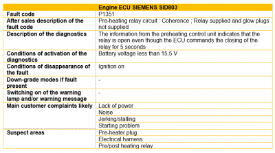

I don't know of many HDIs that don't have the first one referencing Glow plugs not being supplied - I wouldn't worry too much about that one.

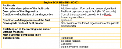

Here's what they say about these specifically for the Siemens system in your car Gibbo:
Click to Zoom Tables
I'm sure somebody else recently has this error with the fuel cap sensor and replaced it. It won't allow a forced regeneration of the DPF whilst this error is active - so I would hope that excludes a normally commanded regen from the engine ECU and only applies to a manually commanded one via Lexia....

Thanks Marc, I thought I'd read before that the first one could be ignored, the additive one seems, as you say, to be concerned only with forced regen, the diagnostics marks the anti pollution system as OK

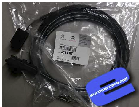

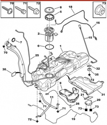

On the Siemens SID 803 injection system for the DW10BTED4 engine, there are 2 types of possibilities - one with the fuel cap sensor and one without. As you are getting the relevant message, this would seem to indicate you have the version with the fuel cap sensor fitted.
From the information I have, if there is a fault, there are several backup modes.
Fuel additive function - Operation in degraded modes.
3 main strategies are used if the additive systems develops faults.
Fuel filler cap faulty.
The additive ECU uses the vehicle speed information and the fuel sender information to inject additive.
Fuel sender fault.
The additive ECU adds an amount of additive equal to that added for a fuel tank When the fuel filler cap is opened/closed.
Failure in communication on the multiplexed CAN network.
The additive ECU adds an amount of additive equal to that added for a fuel tank When communications are interrupted for more than 10 seconds.
So yours is likely to be the first mode engaged with the cap fault.
So here is the fuel sender harness part (6534HY) and a link to a genuine new one, They are £103.99 direct from Citroen inclusive, and £80 from Eurocarcare:
http://www.eurocarcare.net/fuel-cap-sen ... k-cap.html
Fuel sender fault.
Item 25 above | Fuel Sender Harness part (6534HY) |

That first reported error (P1351 - GPs not connecting) would be easy enough to check out - test-lamp or meter.

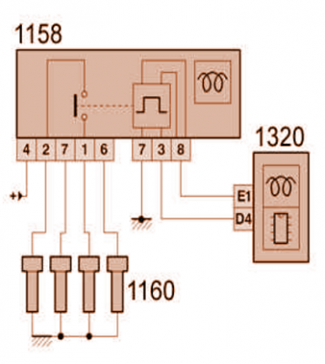

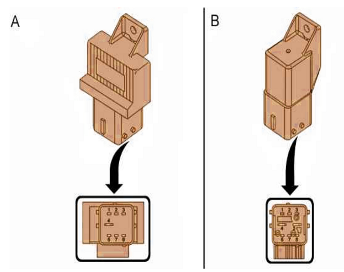

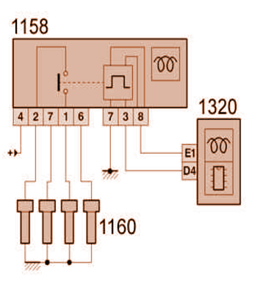

Thanks for reminding me Chris - I almost forgot to put this up earlier.
These were modified on your model Gibbo for an updated relay:
Here's the circuit for info.
Allocation of channels of connector: New 8-way black pre-post heating control unit (1158) (instead of 9-way black (1150) A: NAGARES: Reference 9645668680. B: CARTIER: Reference 9645669280
