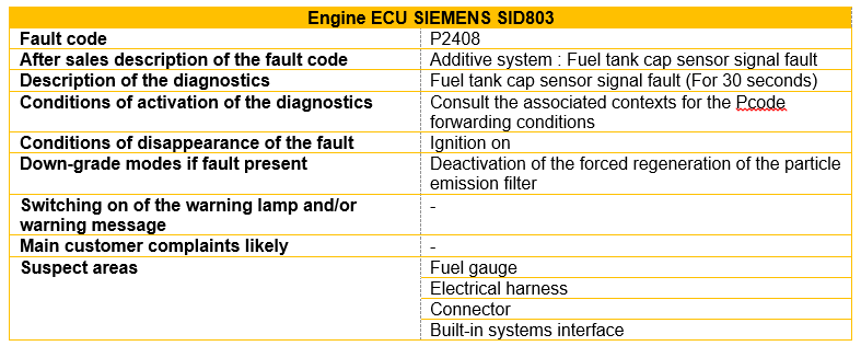

Here's what they say about these specifically for the Siemens system in your car Gibbo:
Click to Zoom Tables
I'm sure somebody else recently has this error with the fuel cap sensor and replaced it. It won't allow a forced regeneration of the DPF whilst this error is active - so I would hope that excludes a normally commanded regen from the engine ECU and only applies to a manually commanded one via Lexia....

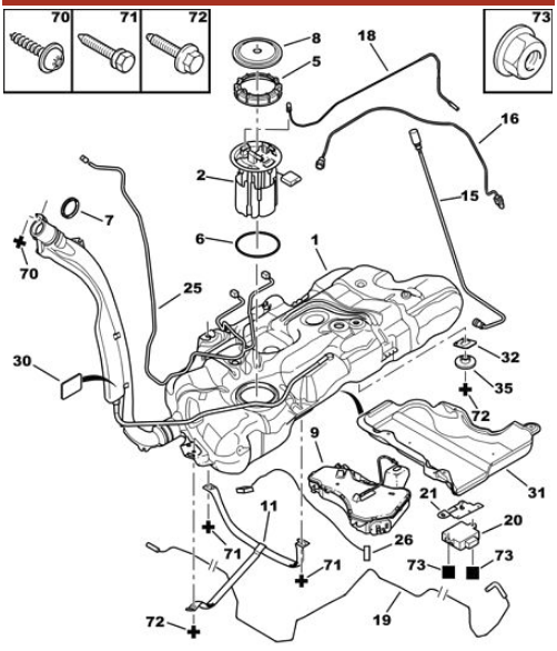

On the Siemens SID 803 injection system for the DW10BTED4 engine, there are 2 types of possibilities - one with the fuel cap sensor and one without. As you are getting the relevant message, this would seem to indicate you have the version with the fuel cap sensor fitted.

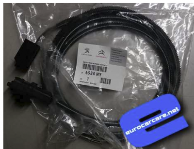

Item 25 aboveFuel Sender Harness part (6534HY)
So here is the fuel sender harness part (6534HY) and a link to a genuine new one, They are £103.99 direct from Citroen inclusive, and £80 from Eurocarcare:
http://www.eurocarcare.net/fuel-cap-sen ... k-cap.html
