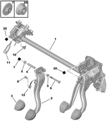

I’ll need a VIN to confirm correct part number, but the earliest berlingo has a brake switch as part (9) in the diagram below:

No worries - right a completely different one then as expected. It is number 11 in the Diagram below:
| There has been a replacement part since the original, and that is part number: 1606480480 It costs £14.64 from Citroen Inc. VAT |

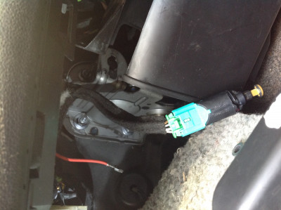

Found the part - see photo attachment. Interestingly brake lights are still on when the switch is detached from loom. So presume it must default to on if not attached.I will look to order new switch Monday.
Just wondering what the loose red wire is though and whether it is related? Can't see where it goes. Presume it is redundant. Wasn't attached to anything when I took cover off. Thought worth mentioning.
- x 6950
Re: Berlingo brake lights stuck on permanently
Not sure to be honest - but I would cover it with insulating tape and tuck it away if it evidently hasn't come off of anything you can see and all is working...
Try cleaning the switch with a contact cleaner.
Did you try manually pressing the switch as if it was pressed by a released brake pedal?
You can adjust how much does the yellow bit protrude from the body, check that.
