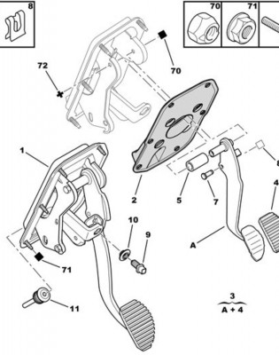

No worries - right a completely different one then as expected. It is number 11 in the Diagram below:
There has been a replacement part since the original, and that is part number: 1606480480 It costs £14.64 from Citroen Inc. VAT |

Great, thanks Marc.
That's why I couldn't see one - it's on other side of car.
