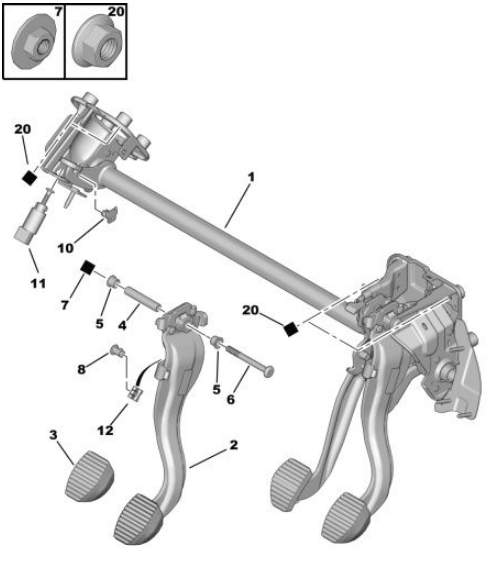

I’ll need a VIN to confirm correct part number, but the earliest berlingo has a brake switch as part (9) in the diagram below:

No worries - right a completely different one then as expected. It is number 11 in the Diagram below:
There has been a replacement part since the original, and that is part number: 1606480480
It costs £14.64 from Citroen Inc. VAT

GiveMeABreak wrote: 23 May 2018, 21:49 It is number 11 in the Diagram below:
Yes that will be it. Had the same thing happen on my C5, and managed to pull it apart and fix it without needing a new one.

Great, thanks Marc.
That's why I couldn't see one - it's on other side of car.

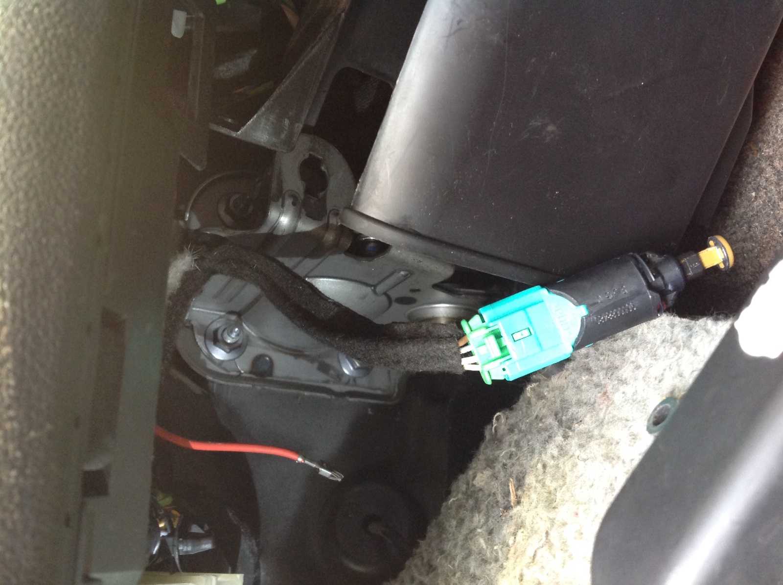

Found the part - see photo attachment. Interestingly brake lights are still on when the switch is detached from loom. So presume it must default to on if not attached.I will look to order new switch Monday.
Just wondering what the loose red wire is though and whether it is related? Can't see where it goes. Presume it is redundant. Wasn't attached to anything when I took cover off. Thought worth mentioning.

Not sure to be honest - but I would cover it with insulating tape and tuck it away if it evidently hasn't come off of anything you can see and all is working...
