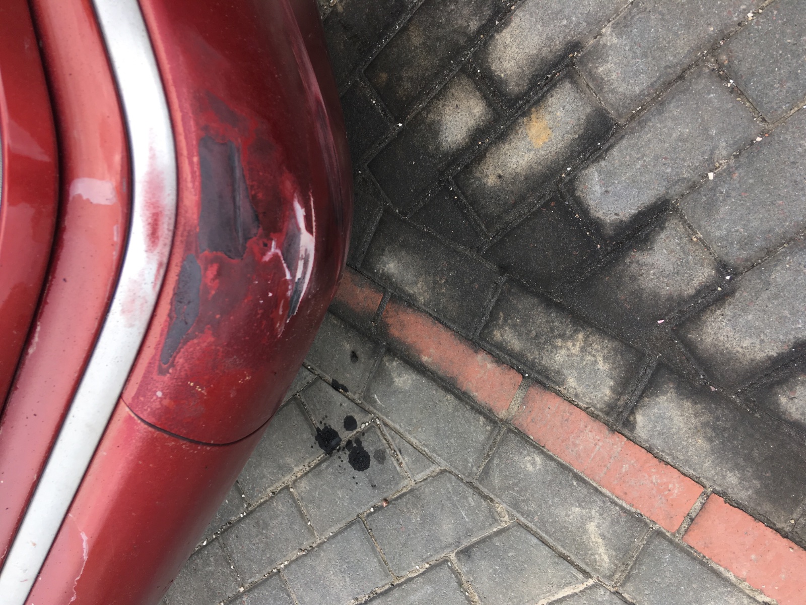

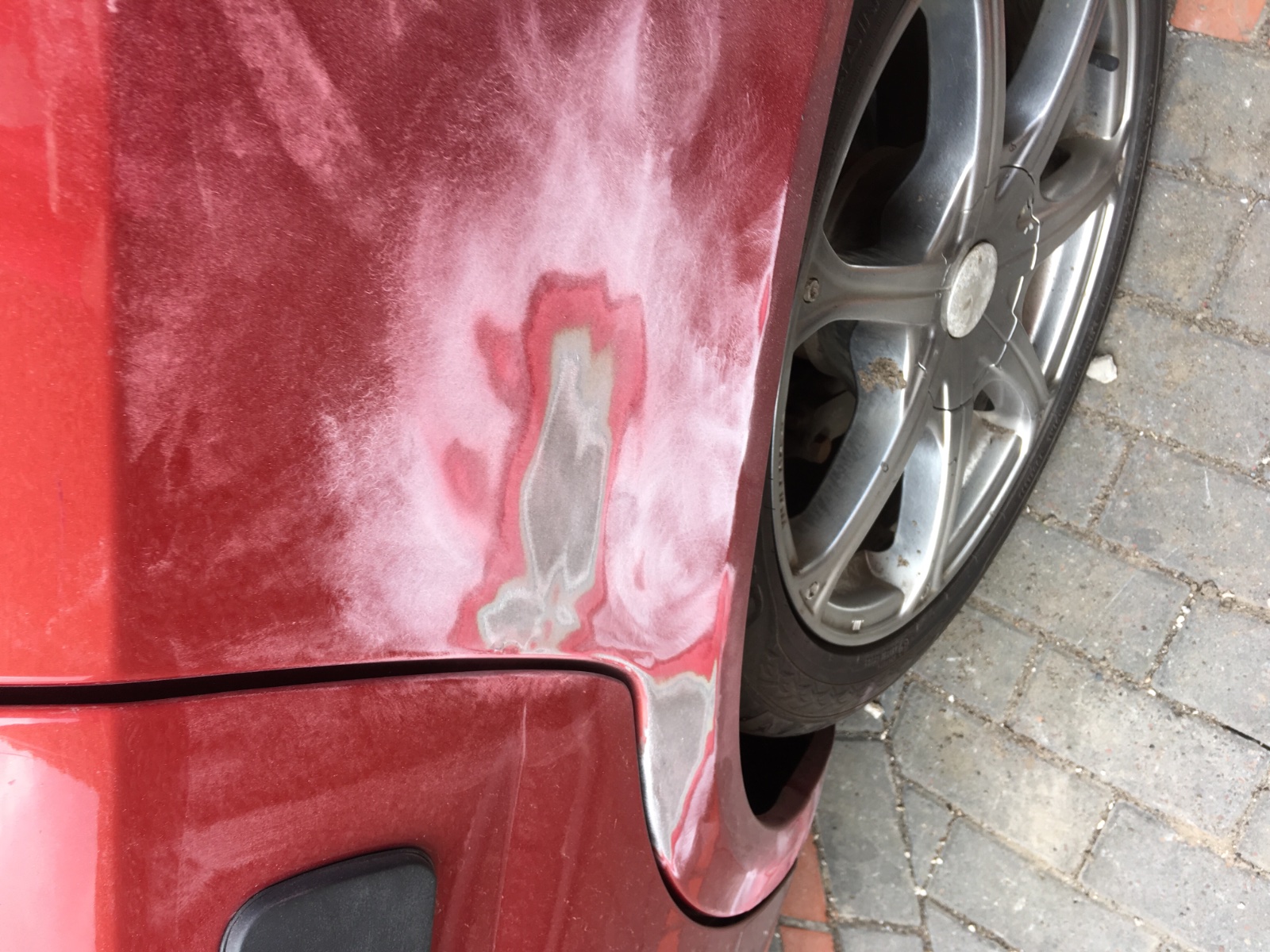

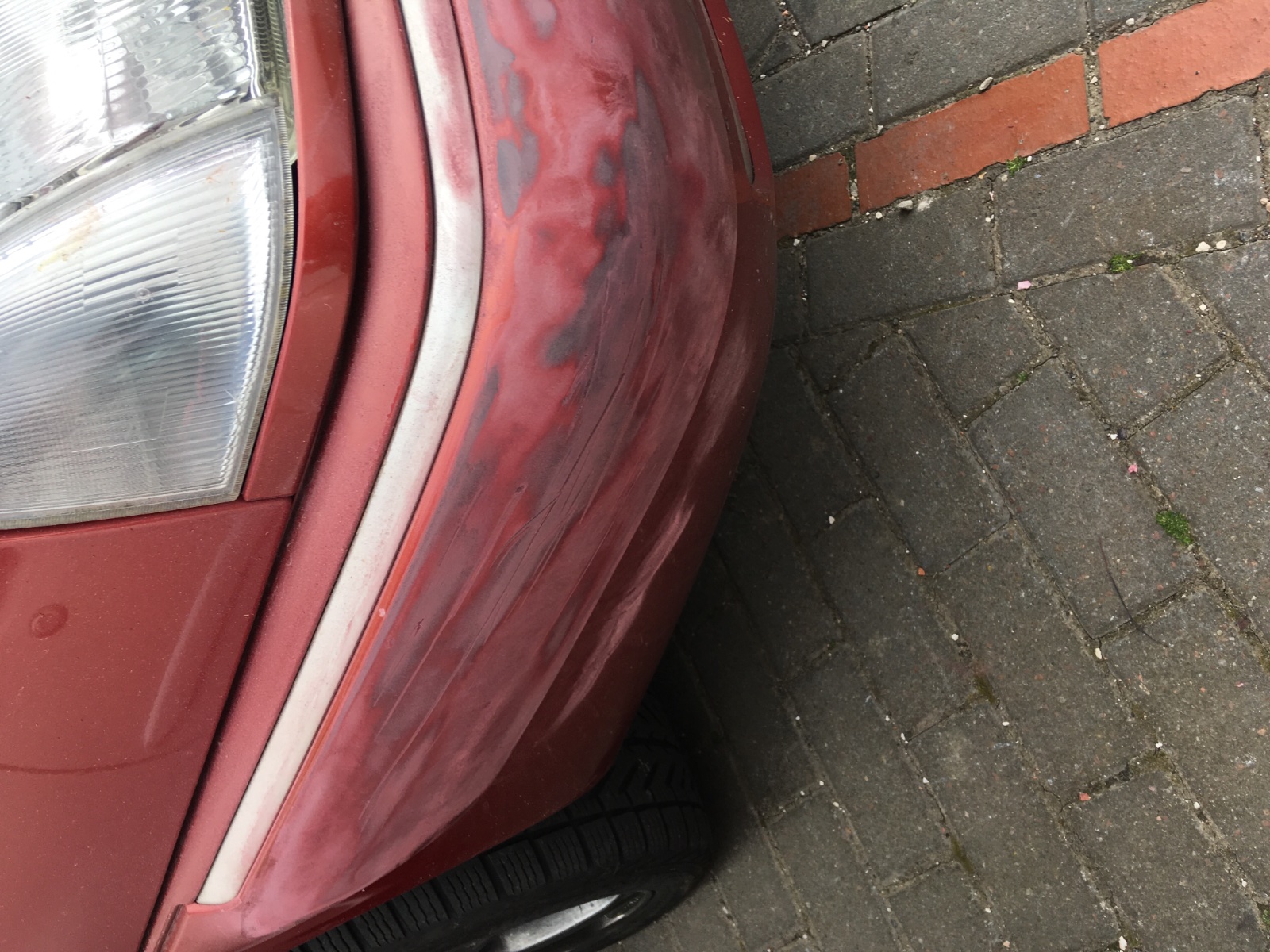

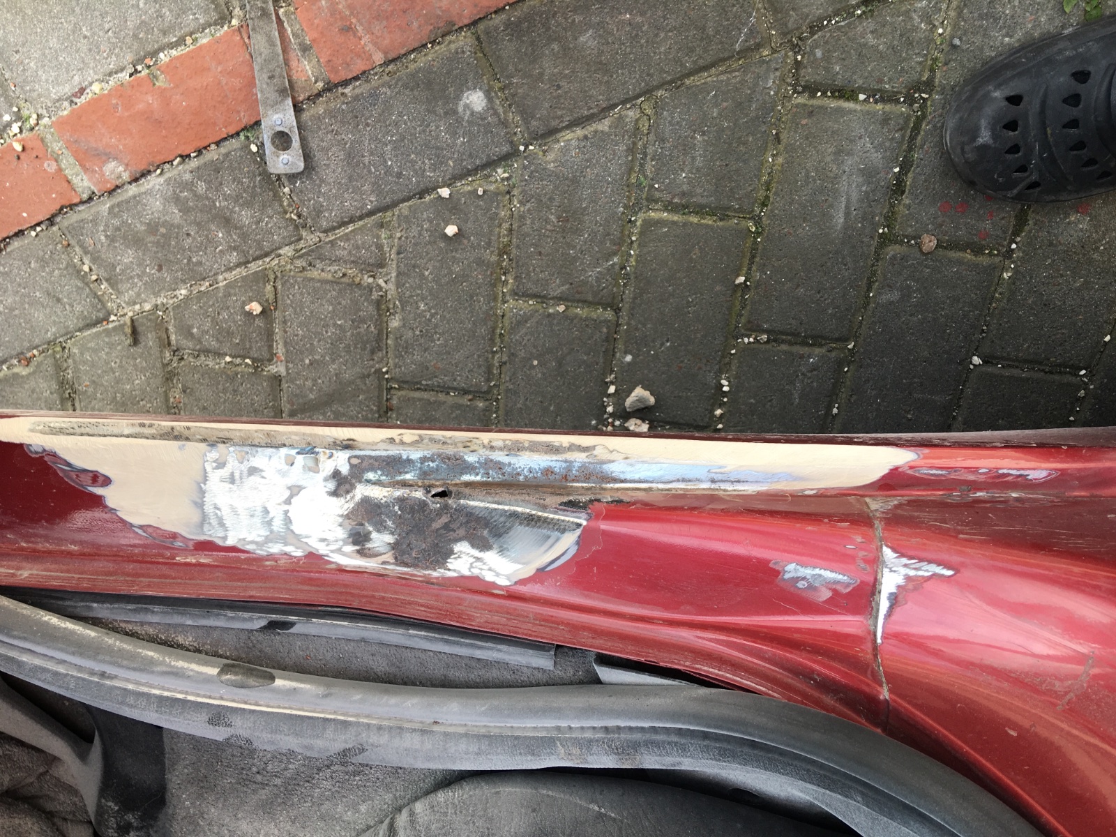

It has started. Gabby getting her freshen up. I’m going to do it all myself. The first stage is rubbing down all the bits that are getting filler. The rear door on the passenger side has a crease the length of it but it is not getting filled. I’m pleased to announce no further welding needed. She is as sound as a pound.

Neither Alasdair, coach enamel with a roller the wet and dry it about 1800 grit or smaller grit then buff it. I've been part of doing that on coaches in the past and I should get a good enough finish and a thicker coat of paint. It's not going a standard xantia colour, and if I ether don't like it or make an arse of it, well it's only a 200 quid run around, although a loved one and not treated like a banger. The tiny hole you can see is the only iffy bit on the car, and it doesn't look like it was caused by rust, the filler on top of it was c?acking, so I just got rid of it and did what the previous repaired did, filled it again. Rain has stopped play now but that's a couple of hours today, that's enough. Tomorrow hoping to smooth the filler and apply primer to that bits then comes the rubbing the whole car down. It's really not bad for the age of the car, just a couple minor scrapes on the back corner and 3 of the bumper corners.

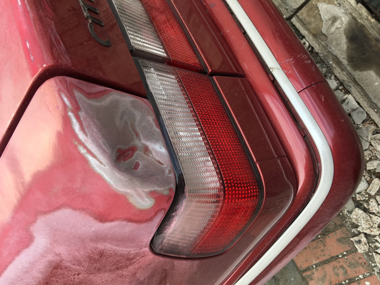

Davie, I apologise for the dent above the rearlight cluster... I did that...
Reversed into a big rock in the car park at Southwick parkrun
Watching with great interest
daviemck2006
- Posts: 5033
- Joined: 04 Dec 2010, 18:45
- x 496
Re: Painting Gabby
Your dent now has a lump of filler in it Jim. It will never be perfect, but will be better. Mark, the 407 is sitting untouched and unloved at the back of the drive. Not yet had the inclination to put it to a garage, and a rather large house expense means I can't afford to, so sit it will have to do. I would consider selling it as it is but it would be worth very little as a non runner. I have asked a couple of local garages and they have no interest in trying to fix it. Garages here are a waste of time.

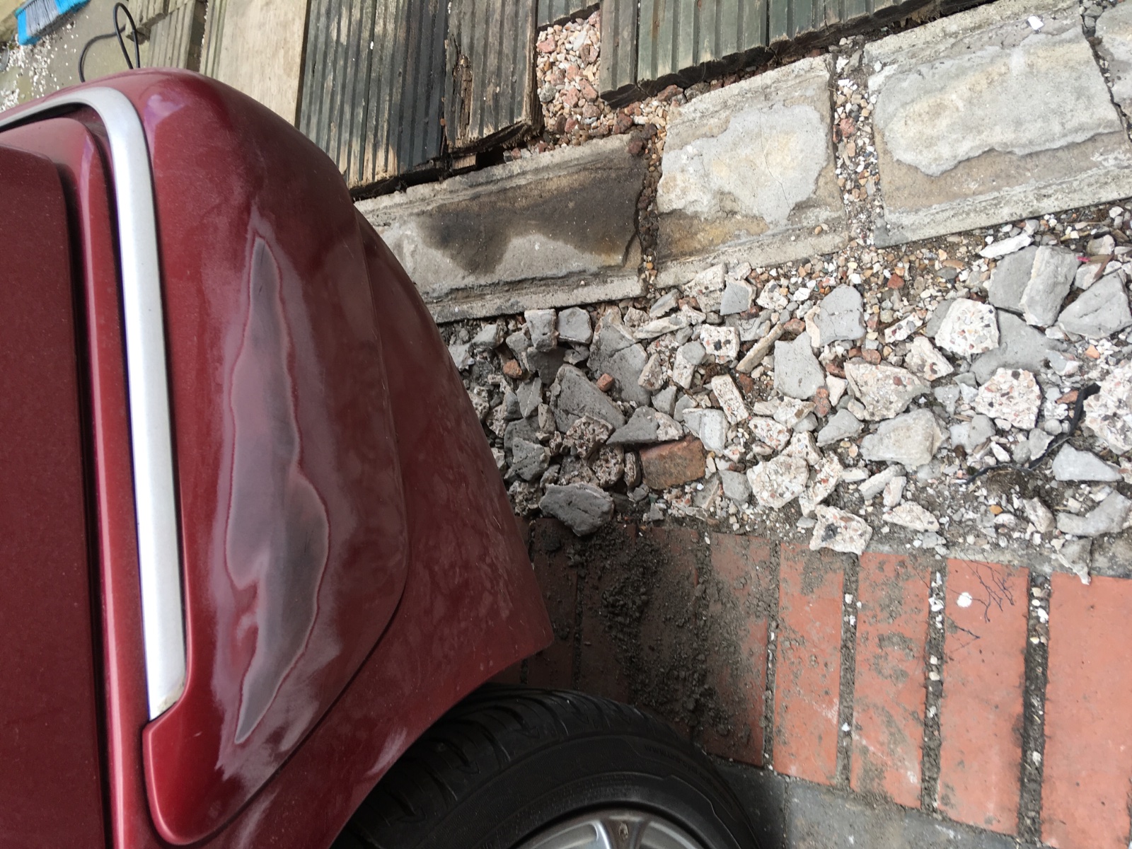

On Gabby, all filler bits rubbed down, a couple of skins of more filler, roof, bonnet, bootlid, door pillars all rubbed down, first coat of primer applied to all the bits which were rubbed down to the metal. Don't think there will be any more progress until at least Monday, apart from maybe putting more primer onto the bare metal bits. It will get possibly 3 coats of primer before flatting ready for top coat.
