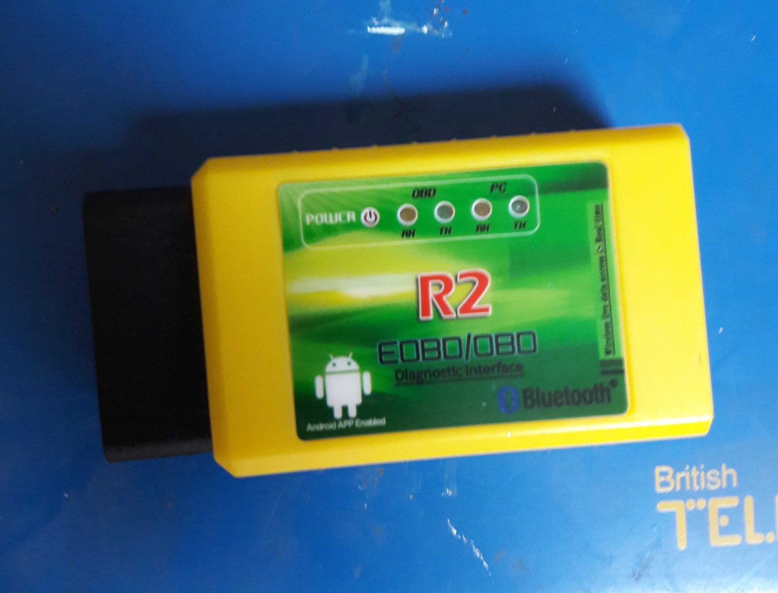

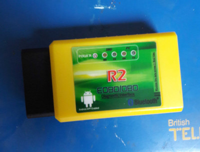

Not tried your Fap thingy but I bought a dongle from Poundstretcher................for £1, it's tiny but seems to work fine on my old Dell laptop

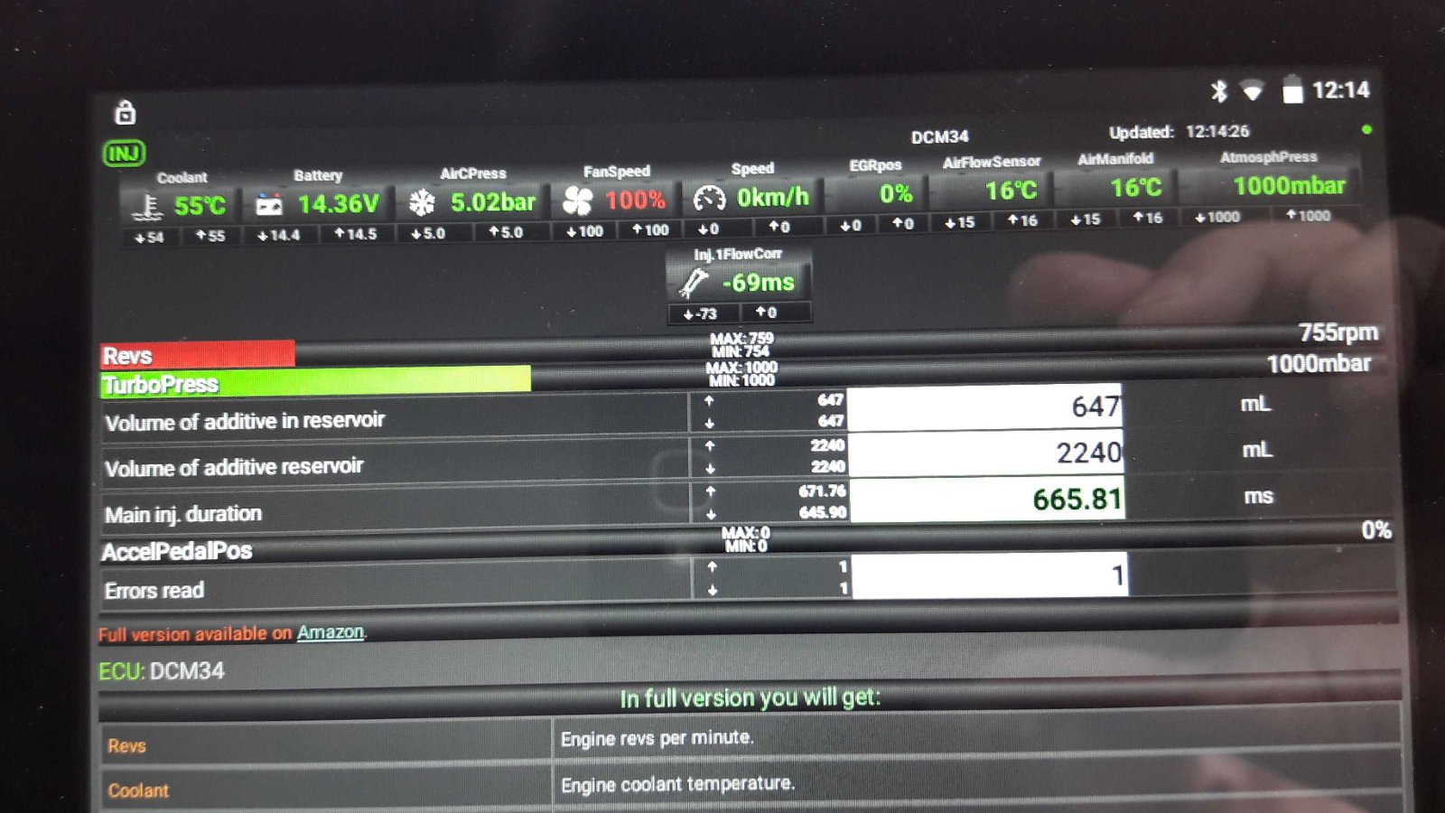

Prompted by Xantippa's request yesterday, I downloaded FAPlite to see what it could do - and it's actually quite good
It worked 'straight out of the box' for me using an old OBDII reader I've owned about 4 or 5 years: FAPlite (as opposed the paid for version) gave me these readings straight away:
Not sure about the Fan Speed 100% reading though !!

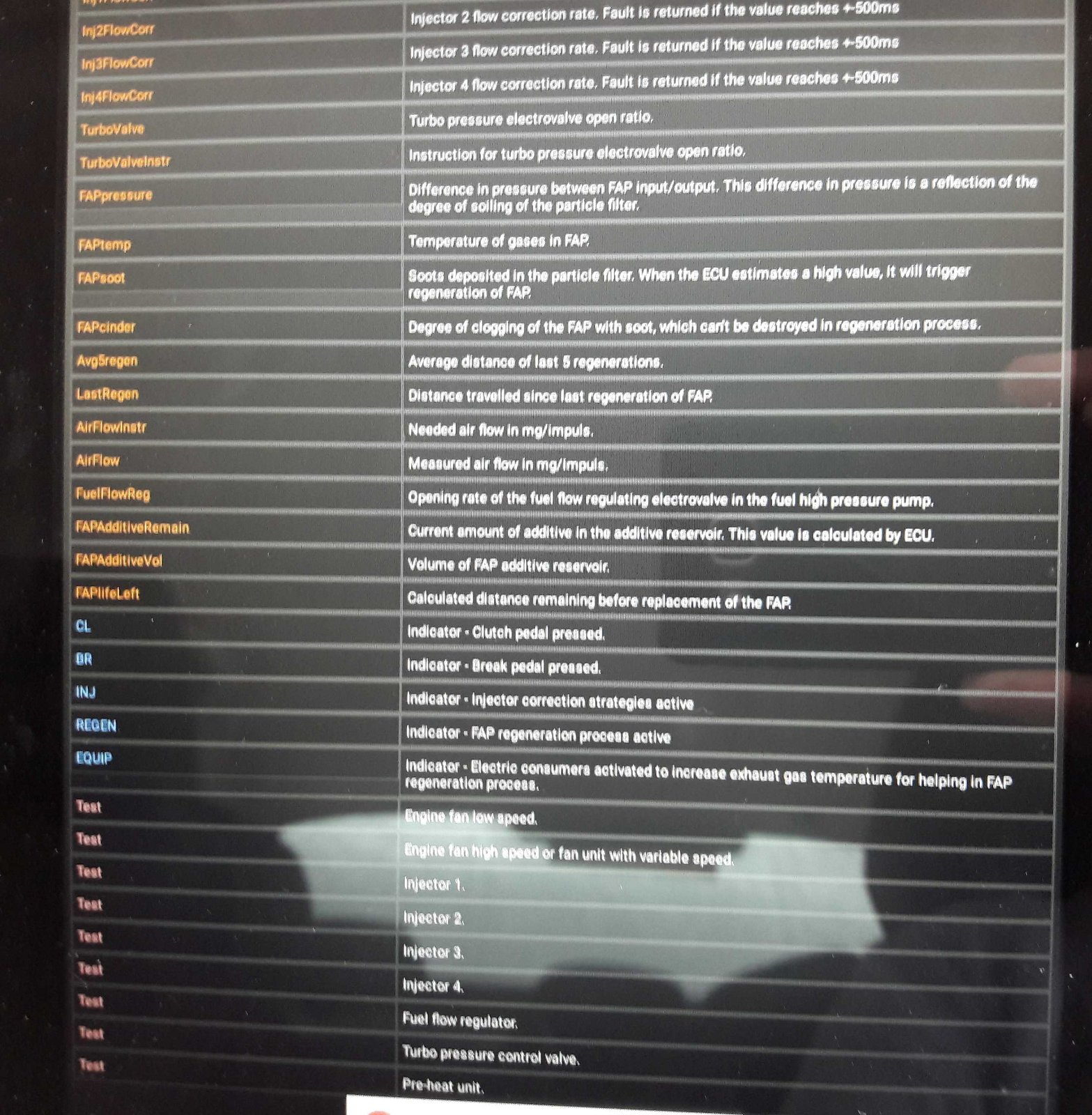

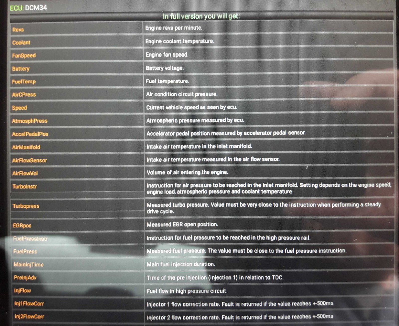

If you go for the 'paid for' version you should get the following listed additions (note - some are already available in the free version) I tried out the cooling fan actuator test incorporated into FAPlite and it span up the engine fan no problem.
