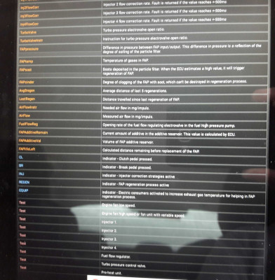

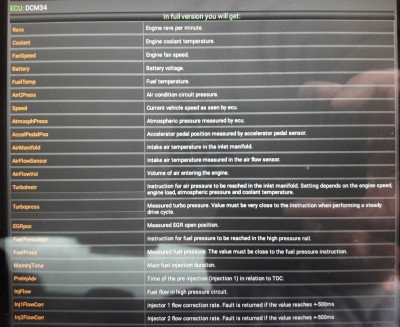

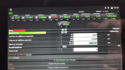

Prompted by Xantippa's request yesterday, I downloaded FAPlite to see what it could do - and it's actually quite good
It worked 'straight out of the box' for me using an old OBDII reader I've owned about 4 or 5 years: FAPlite (as opposed the paid for version) gave me these readings straight away:
Not sure about the Fan Speed 100% reading though !!
If you go for the 'paid for' version you should get the following listed additions (note - some are already available in the free version) I tried out the cooling fan actuator test incorporated into FAPlite and it span up the engine fan no problem.
FAPlite reported a preheat fault but wouldn't clear it - not surprising really as I think that's a spurious fault anyway !
FAPlite worked straight away on both my Samsung Galaxy A3 phone and Lenovo tablet running Android 6.0.1
I'm very tempted to go for the paid for version, although more out of interest than any real diagnostics necessity.
Note - diagnostics performed on 2009 C5 X7.

- x 3566
Re: FAPLite
It's useful if only to quickly and painlessly check how much additive is left in the reservoir
