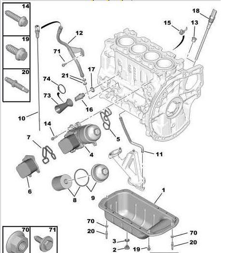

I am looking for some help in locating the oil pressure switch on my Citroen Xsara Picasso 1.6 Hdi 90. I have looked everywhere and cant see to spot it, I was expecting it to be around the oil filter house / Oil Pump but nothing
I will be looking to replace the oil pressure switch and also test the engine has oil pressure
any info or photos would be great

Here you go - it is number 16 on the diagram:
Click diagram to zoom

Thanks il have a look for it in the morning. is it easy enough to see? can you advise what its closest to? spent so might time with a touch trying to track it down

Found it, Perfect Thanks

Hi could anyone tell me where the oil pressure switch is on a citroen picasso xsara please would begrateful for a photo
x 6946
Re: Citroen Xsara Picasso 1.6 Hdi 90 Oil Pressure Switch Location
It's as above in the diagram - item 16.
Follow the engine oil dip stick guide tube to the bottom. It's immediately behind and just above where the guide tube ends.

chrisfox15 wrote: 17 Feb 2018, 11:23 Found it, Perfect Thanks
So how did you get yours out , looks very much a DPF removal just to do a simple job. No one tells you till you LOOK yourself.
