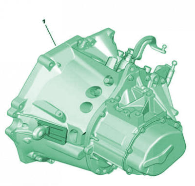

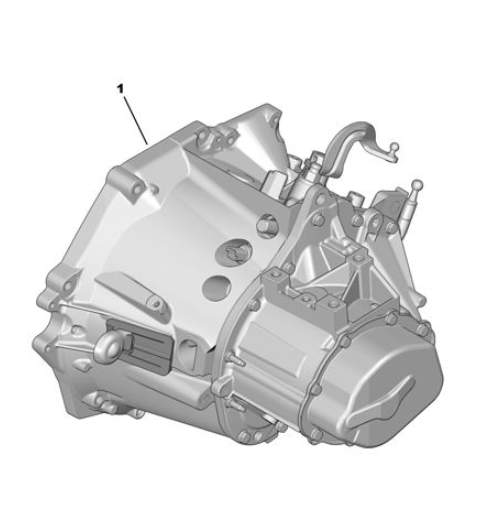

Ok, that's all sorted, thanks for that. So you have a BVM5 (BE4-5L) BE4R Manual Gearbox with REAR AXLE HYPOID GEARSET 19 X 72.
Your Gearbox had an original Citroen Part number of 2222QS. It is a CP 19X72 and may have the following markings: DP2J or DP29.
However that box is not available so Citroen recommend one of the reconditioned boxes that have part 2223ZF. This again is a CP 19X72 but may have the following markings: DPB9, DP29 or DP2J.
The current price for a reconditioned gearbox (2223ZF from Citroen today is £2,211.74 inc. VAT, but at least you have the PSA part numbers and the gearbox codes / markings to help with searching for a second hand one.
Either of these will be fine.

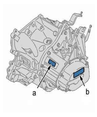

Your gearbox will have the identifications marked here:
Etched area (a) (type and serial no).
Location of the identification label (b).

Re: Xsara Picasso gearbox
Hi Marc
I take it that Etched Area (A) (Type and serial No) are where the 20DP29 and long serial number is, and (B) the the location of where the 2222QS or 2223ZF same as Andys as above which means as long as the numbers match I aint restricted to it coming off an Exclusive model....
