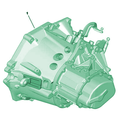

Ok, that's all sorted, thanks for that. So you have a BVM5 (BE4-5L) BE4R Manual Gearbox with REAR AXLE HYPOID GEARSET 19 X 72.
Your Gearbox had an original Citroen Part number of 2222QS. It is a CP 19X72 and may have the following markings: DP2J or DP29.
However that box is not available so Citroen recommend one of the reconditioned boxes that have part 2223ZF. This again is a CP 19X72 but may have the following markings: DPB9, DP29 or DP2J.
The current price for a reconditioned gearbox (2223ZF from Citroen today is £2,211.74 inc. VAT, but at least you have the PSA part numbers and the gearbox codes / markings to help with searching for a second hand one.
Either of these will be fine.
Your gearbox will have the identifications marked here:
Etched area (a) (type and serial no).
Location of the identification label (b).
