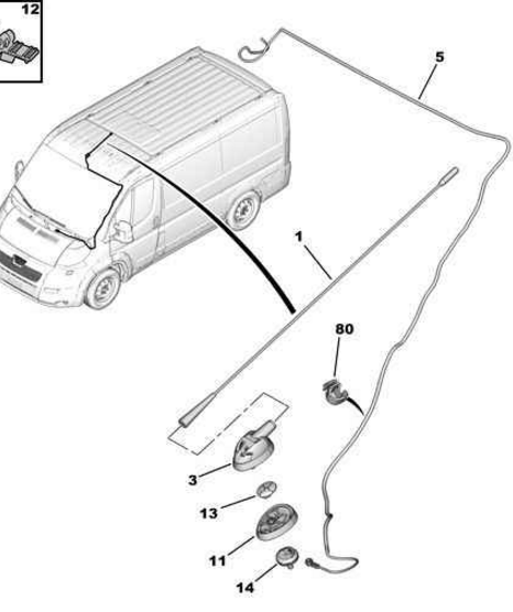

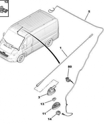

As I already mentioned about the amplified aerial in my first post - here is the unit with the amplified base I mentioned - similar to this. I can't be specific without a VIN and an RPO - as there are so many variants of these vans and as some are Fiat Hybrids, not all the diagrams are available.GiveMeABreak wrote: 13 Dec 2017, 19:57 It is likely to be water and/ corrosion in the aerial wiring or the small amplifier unit (if fitted). Sometimes water can get in and cause havoc.

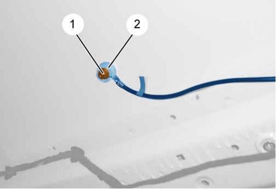

Ok, it's as I originally posted - so no change (good guess
There's nothing about the base being amplified, and also no other identifiable amplifier boxes or adapters as there are in the C5 for example - but here is a better picture of the aerial fixing under the headlining:
