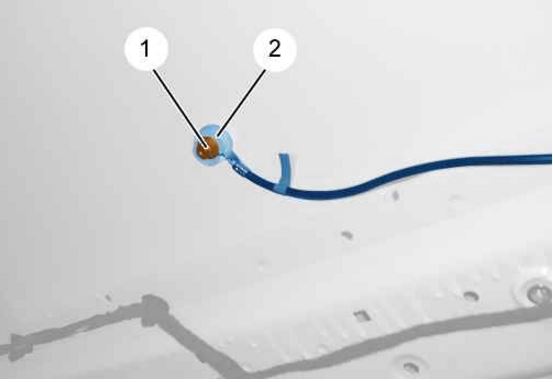

Ok, it's as I originally posted - so no change (good guess
There's nothing about the base being amplified, and also no other identifiable amplifier boxes or adapters as there are in the C5 for example - but here is a better picture of the aerial fixing under the headlining:

Re: Citroen relay stereo problem
Ok a bit stuffed then as I have replaced the aerial and cable and stereo and the problem is still there so a bit lost now
