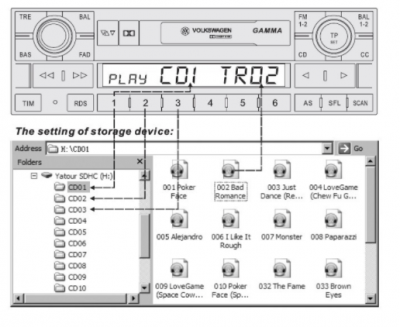

Then all you have to do is when creating folders on a USB or SD card for music, create the folders CD01, CD02, CD03 CD04 etc. Then you can place your MP3 files into these folders. You likely won't get the titles displayed, but you will get CD01 and Track number displayed.

Good on ya - here's what I was on about for structuring the music content Pat: (click to zoom).
Not a perfect solution - but better than what you have now!

My radio head unit looks a little different than that though
https://ae01.alicdn.com/kf/HTB1R0mKIVXX ... XFXXXA.jpg
Should work the same no? Also how about just a 3.5mm directly to the cd changer connection? It doesnt look like it would work though in fairness if the port is expecting a cd changer

Yes, this is just a generic picture from their website to demonstrate the CD naming and structure and to show the sort of display you might get. Ignore the stereo!
