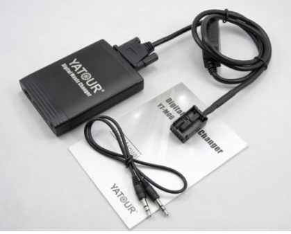

Basically, the supplied lead plugs into the back of the Head Unit into the CD Changer Port. The unit then provides a slot for an Sd / MMS card, USB or Jacks for iPods and MP3 players and the like.
This is the kit - not too obtrusive so can be kept in the glovebox which is quite near to the head unit - so should avoid any untidy wiring. Here is their Diagram showing Connectivity What you will need, is to ensure that the CD Changer is enabled on the Car (using a Lexia / Diagbox) and also that the CD Source is enabled as an Audio Source form the Audio Menu.
Then all you have to do is when creating folders on a USB or SD card for music, create the folders CD01, CD02, CD03 CD04 etc. Then you can place your MP3 files into these folders. You likely won't get the titles displayed, but you will get CD01 and Track number displayed.
Here is the link to the product on Amazon for about £53 - so this might be a quick and easy solution for you

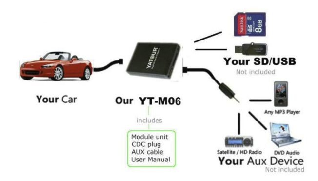

Good on ya - here's what I was on about for structuring the music content Pat: (click to zoom).

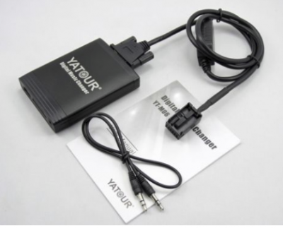

My radio head unit looks a little different than that though
https://ae01.alicdn.com/kf/HTB1R0mKIVXX ... XFXXXA.jpg
Should work the same no? Also how about just a 3.5mm directly to the cd changer connection? It doesnt look like it would work though in fairness if the port is expecting a cd changer

Yes, this is just a generic picture from their website to demonstrate the CD naming and structure and to show the sort of display you might get. Ignore the stereo!

No it won't work - the Yatour unit contains the CD connector plug and the unit contains the Jack, the SD Card Slot and USB for your tunes. A 5 minute job.
