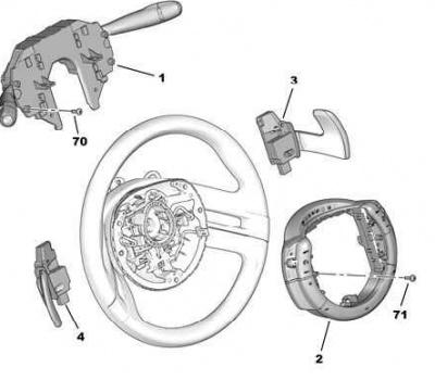

Ok, so you have the standard RD45 MP3 / CD Player unit, & Hands Free Nomad Kit.
I have to say that these RD45 units commonly suffer from issues like the volume going up and down itself, no sound, CDs getting stuck, fried amplifer IC chip etc. I would of suggested a firmware upgrade - but there are no firmware upgrades for these units.
It could be that the mute button is sticking on the steering wheel control switch module (item 2 below), causing the random engagement of the mute function. Maybe some electrical contact cleaner under there might help. (Never undertake any maintenance with the battery connected - disconnect the battery for 10 minutes before doing any work around here to prevent accidental activation of the airbag module).

Hi Marc, did as you said and all is well again Lucky I had a can of switch cleaner sat in my cupboard. Such a simple fix as well.
Thanks
Bob
x 6950
Re: Factory Radio and silence
No worries Bob, there's such a lot of kit packed under there, I suspect it is easy for the steering wheel boss cover to get a bit stuck occasionally - especially with the contracting and expanding due to the heat / cold. Glad it's sorted.
