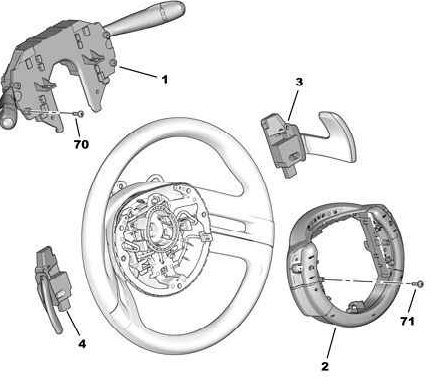

It could be that the mute button is sticking on the steering wheel control switch module (item 2 below), causing the random engagement of the mute function. Maybe some electrical contact cleaner under there might help. (Never undertake any maintenance with the battery connected - disconnect the battery for 10 minutes before doing any work around here to prevent accidental activation of the airbag module).
Ok, so you have the standard RD45 MP3 / CD Player unit, & Hands Free Nomad Kit.
I have to say that these RD45 units commonly suffer from issues like the volume going up and down itself, no sound, CDs getting stuck, fried amplifer IC chip etc. I would of suggested a firmware upgrade - but there are no firmware upgrades for these units.

Hi Marc, did as you said and all is well again Lucky I had a can of switch cleaner sat in my cupboard. Such a simple fix as well.
Thanks
Bob
Thanks
Bob
- x 6960
Re: Factory Radio and silence
No worries Bob, there's such a lot of kit packed under there, I suspect it is easy for the steering wheel boss cover to get a bit stuck occasionally - especially with the contracting and expanding due to the heat / cold. Glad it's sorted.
