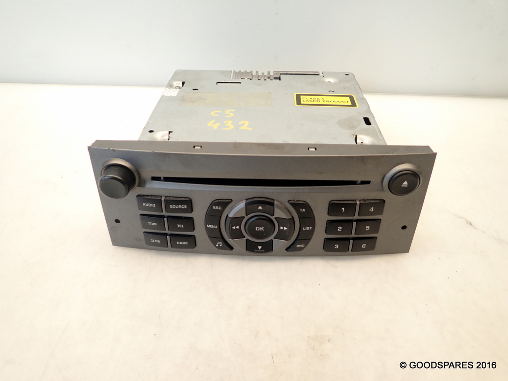

this is the radio in it btw, if theres no phone on it can i stick in an aux usb on the back. photo lifted from here

Ok, so looking at your specs, there is no Telephone Kit supplied, so you just have the RD4 unit. This unit can support a CD-Changer - but in place of the CD, some have put a Yatour or similar device in that provides MP3 playback via a USB port or an MMC / SD Card - item here:
https://www.amazon.co.uk/YATOUR-Digital ... B005V756ZG
They do have another model that supports Bluetooth:
https://www.amazon.co.uk/Adaptor-Blueto ... F7ARDFS8HK
Although on the later one, you'll have to make sure the unit is not made by 'Continental' - if Magneti Marelli you should be ok - removing the head unit should identify it.
