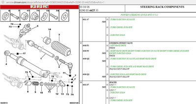

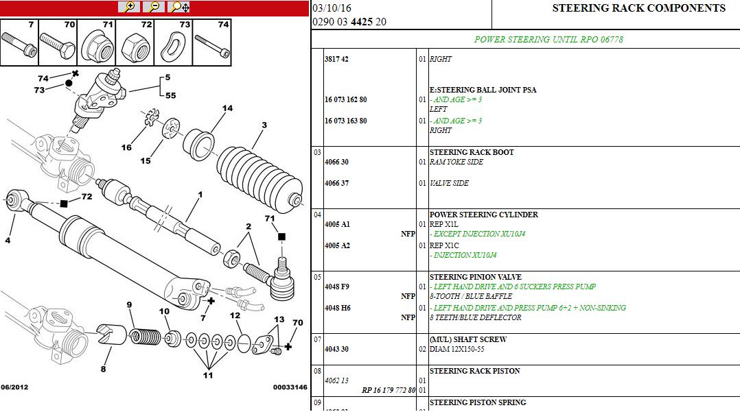

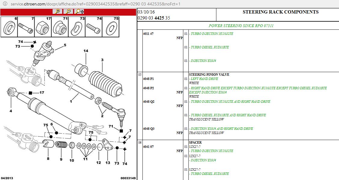

Does anyone know what are the differences between the following steering pinion valves
4048F9
4048P1
Are they interchangeable ?
Thanks

I would say that the information suggests that they are not interchangeable, one is for cars with sinking suspension and FDV, and the other is for later cars with more conventional steering hydraulics.
