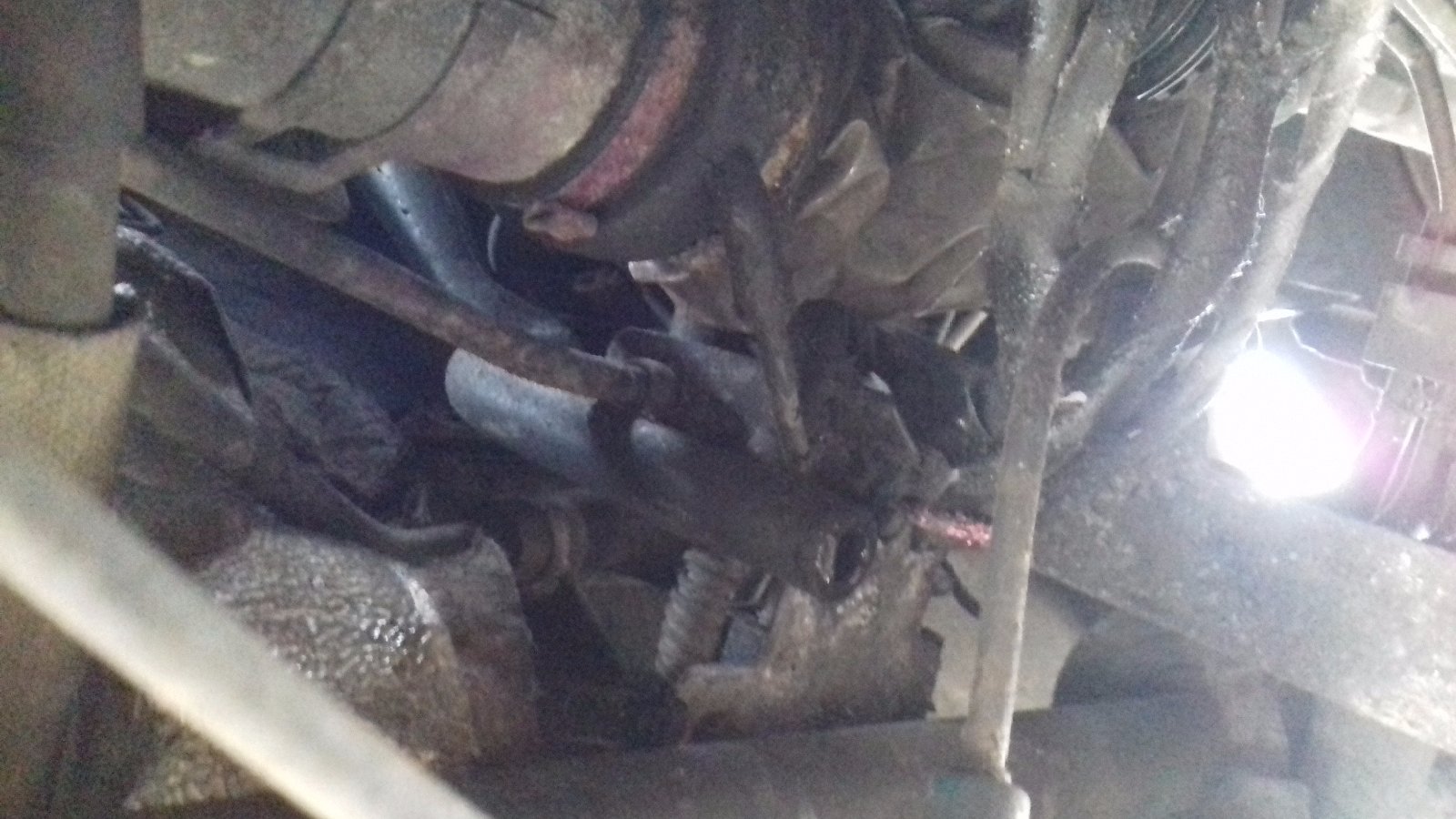

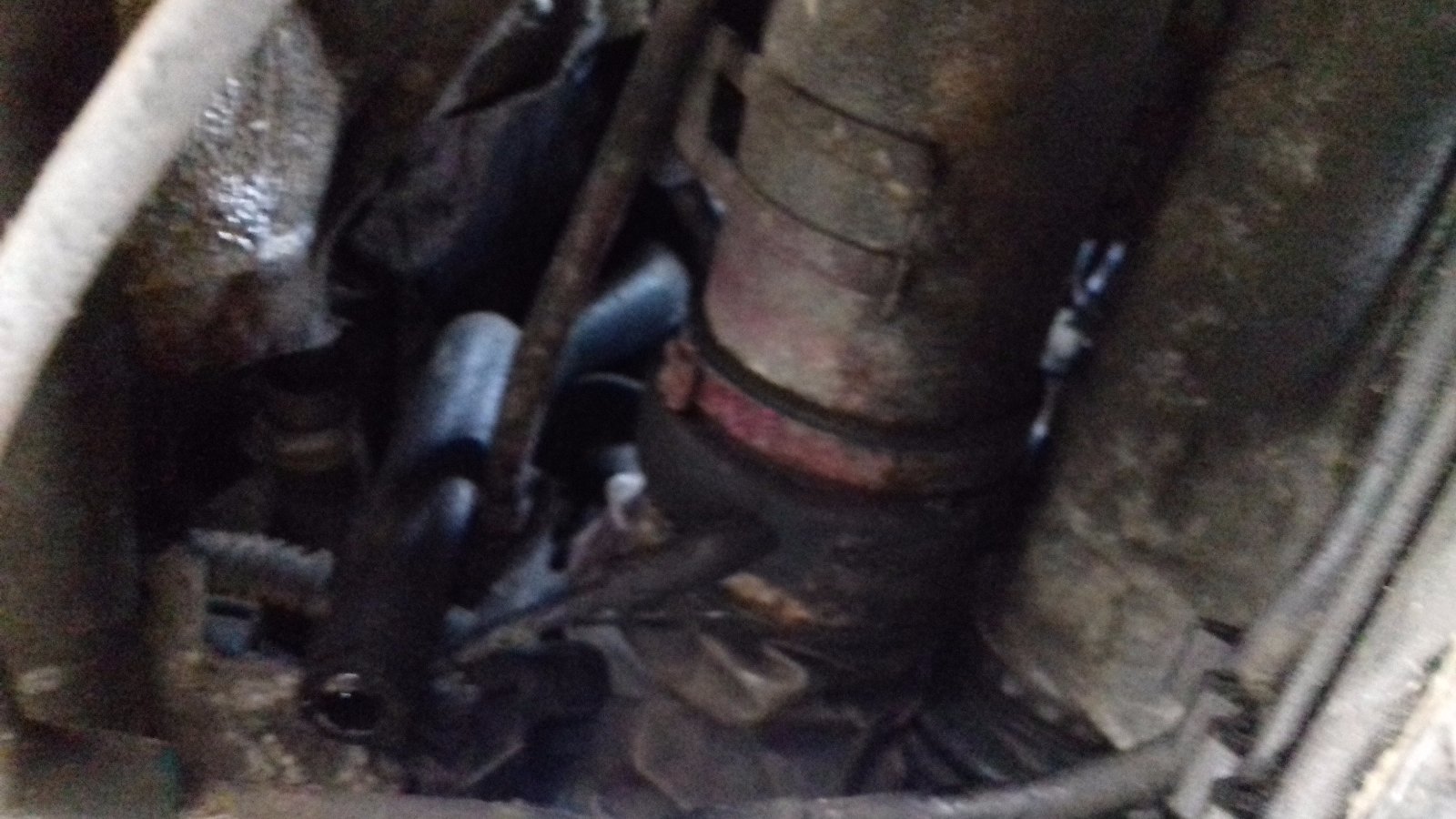

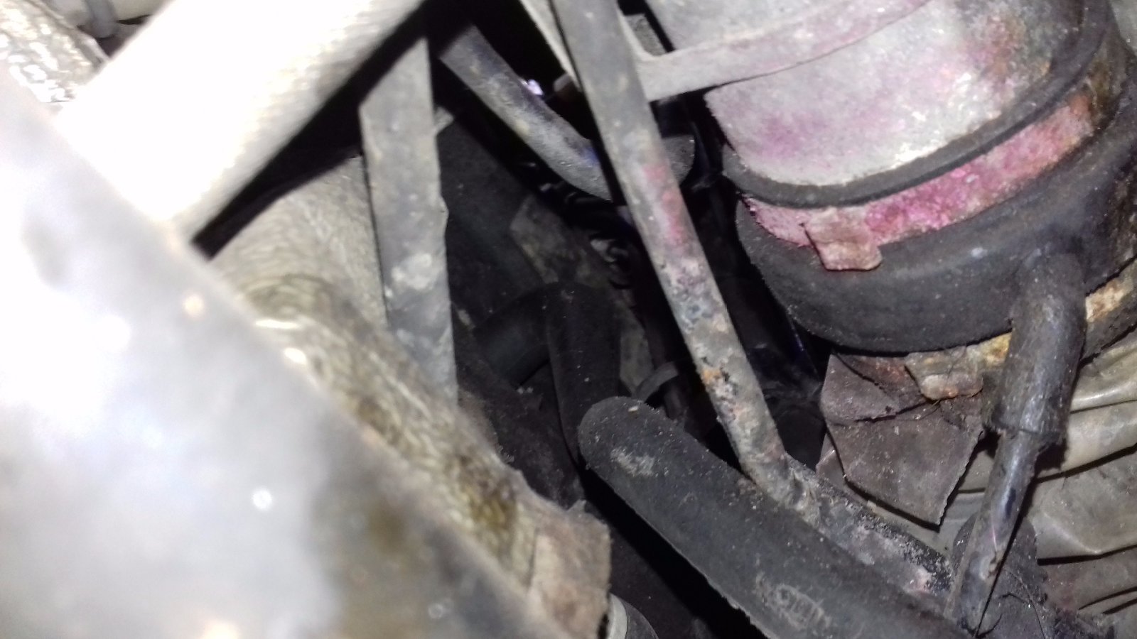

Can anyone id this hose please?
Its dripping what seems to be fresh water rather than coolant.
I cant see anywhere it should be attached to.
Its on my xantia (v6). It goes into the bulkhead jyst above the plastic bag steering rack gaitor.

It's the drain from the AC, totally normal to be dripping clean water

Brilliant, that'll be because it was regassed this morning.
Thank you Richard.

I've once seen a case of where that was broken - you have to be cautious with it if you ever have reason to remove the heater box complete - and the effect was a persistent leak of water into the passenger compartment ending up under the passenger footwell carpet...
Same symptom as a failed scuttle seal...
I fixed it by sleeving it with a tight-fitting length of plastic pipe covered in silicone RTV sealant...
