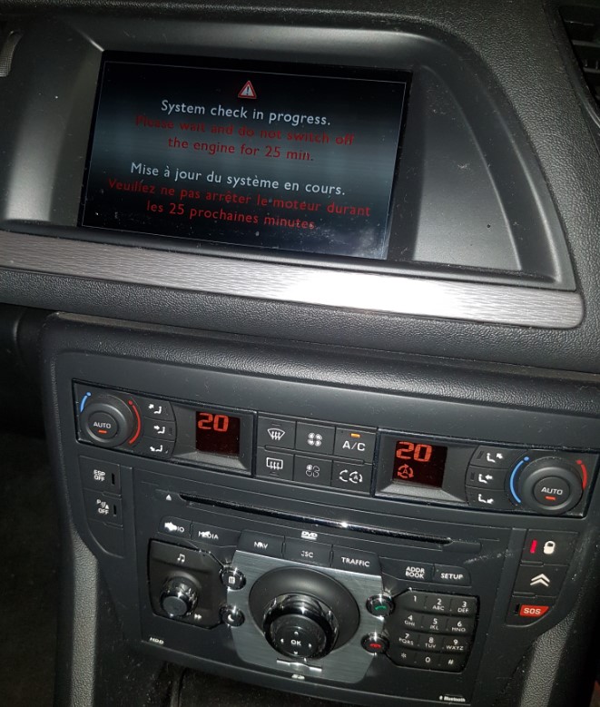

Hi All
The multifunction screen on my 2011 C5 suddenly stopped working throwing up the following screen message
SYSTEM CHECK IN PROGRESS.PLEASE WAIT,DO NOT TURN OFF ENGINE FOR 25 MINS.
I did this but the screen keeps giving the same message.I now have no radio,sat nav,bluetooth etc
Can anyone share any info or advice on this problem please
Thanks in advance
Thanks in advance

Ok, so you have the same system as me, the NG4 Navidrive 3D. The first thing to do is to check the firmware version you have. With system switched on, press the SETUP button briefly and scroll down to SYSTEM. Select this and it will tell you the Firmware version you have. Let me know what it says or take a screenshot.
A bit of background
It is possible that your hard drive is playing up and is starting to have problems reading some data. Now, I have known this error to be corrected by a firmware update - which will update the system partition and should re-write the data, avoiding any bad blocks. These hard drives are high quality automotive grade units that are designed to withstand extremes of temperature, shock and vibration as you would expect. However they do have an operational life like anything, but they are very difficult to get hold of now as they are of the old PATA interface type and are very expensive. Solid State Drives (SSDs) has been tried as a replacement with an adapter and a modification, but with limited success, due to inherent differences in the way blocks of data are written to on an SSD, and the differences in the file system used on the NG4's operating system.
Other possible causes may be if you (or the previous owner if not you) used the 'Jukebox' function. The facility exists to 'rip' CDs to the internal hard drive of the system, or to copy music files to the drive from an external source like an SD card or via the USB port. If you do play music using the jukebox function, then the hard drive is obviously doing a lot more work - playing music, chopping and changing tracks, calculating the Navigation route data, handling the telephone calls, radar alerts and traffic info, voice synthesis / commands, etc., etc. The unit has an internal fan, but if the heating is on in the car, then it will have a harder job to try and cool the system. These units though are generally very reliable and problems are far rarer than some of the other systems.
Personally, I don't have any music files stored on the internal hard drive. I use a 32Gb SD card, that I have all my MP3 files stored on in folders. I insert the SD card and play everything from that - this results in less work for internal drive and will hopefully prolong its life.
On the positive side, let's see what firmware you have first of all, apply an update if applicable and see if that resolves the problem. If we can resolve that issue, I would get rid of any music stored internally (if present) and would suggest using the option I recommend for playing media files.

Marc,
Many thanks for that comprehensive reply,but herein lies the problem......my system seems to be stuck/hung up on this system test screen.Its unresponsive to any of the buttons
Any ideas?..Am i in trouble?

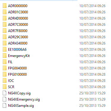

Can you confirm the contents of the USB drive Alan, if the contents aren't exactly right it won't work. I'll tell you what is supposed to be on the drive in a while as away from my PC for the next 40 mins. Once I've verified them, we can try restarting the car with the USB already in the drive and see if that can kick in before the loop starts. After that we'll have to try a BSI reset.
- x 6957
Re: 2011 C5 Tourer multifunction screen
OK, so the first picture is what is supposed to be in the route of the USB drive and no other files. Then inside the 'HEADUNIT' folder shown, there should be the contents of the second picture. Can you confirm is was formatted as FAT32 and that the contents are as shown Alan?
