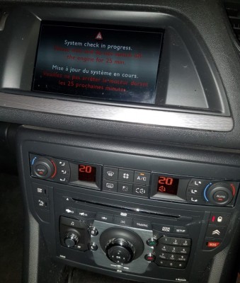

The multifunction screen on my 2011 C5 suddenly stopped working throwing up the following screen message
SYSTEM CHECK IN PROGRESS.PLEASE WAIT,DO NOT TURN OFF ENGINE FOR 25 MINS.
I did this but the screen keeps giving the same message.I now have no radio,sat nav,bluetooth etc
Can anyone share any info or advice on this problem please
Thanks in advance

Many thanks for that comprehensive reply,but herein lies the problem......my system seems to be stuck/hung up on this system test screen.Its unresponsive to any of the buttons
Any ideas?..Am i in trouble?

Have tried long hold on set up button but nothing.Screen just blacks out and returns to test screen.
