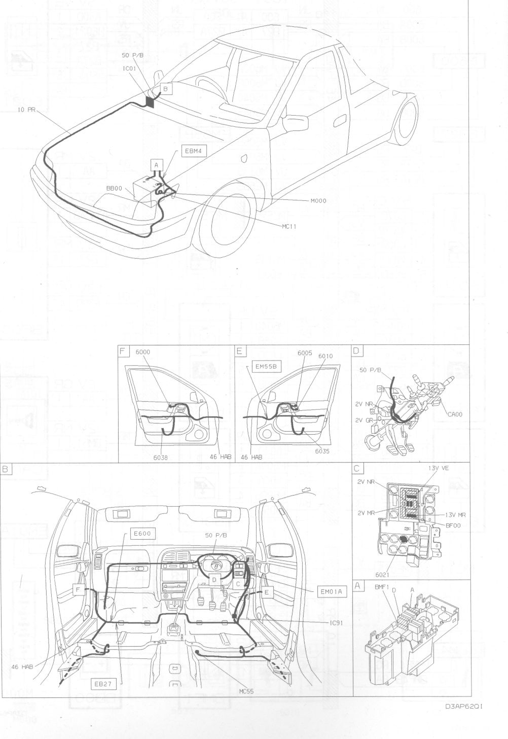

Thanks for your suggestions fellas. I managed to get the regulator assembly out though wondered about the mental state of the "designer" of the block clip setup". Mungrel. There is no visible issue with any part - plastic, wire or carrier. Not sure now how to test the black box/motor. Any suggestions on how to go about testing?.

I would firstly clean the window guide rails very carefully and check, with the regulator assembly out, that the glass slides very freely up and down...
The regulator mechanism can be tested without being 'connected' to the window glass, just be careful not to over-run it at the extreme ends of travel.
I can supply a wiring diagram if that would help?

Thanks for the offer of a wiring diagram Jim....think I'm going to need it....just can't figure how the window got lowered ... don't think a wire short at the door exit could send the thing into down mode given it was just sitting around.

Here you go sirMoss wrote:Thanks for the offer of a wiring diagram Jim....think I'm going to need it....
Front Electric Windows Circuit
Front Electric Windows Harnesses
Front Electric Windows Locations
Hope they help solve the issue

Well finally got time to look at the wiring, had been thinking switch was dodgy because the window let itself down. Pulled the switch out and HO! three wires had popped. Put them back by looking at length and probable spot method (otherwise known as R.S.B.) and plugged the power assembly in then flicked the switch. Cooked a wire...melted the insulation in a flash so now know there's juice coming to the switch. Now don't know weather the motor is the problem or the switch so plan on getting the motor checked.
