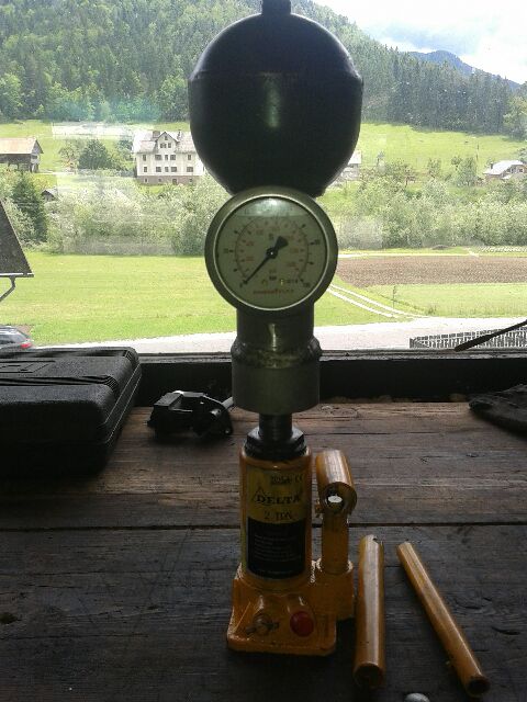

Re: Sphere tester
And here is mine made from hydraulic jack and rear Xantia cylinder... Works great and simple to use and manufacture...

Re: Sphere tester
That's extremely neat and simple, Xantos.
