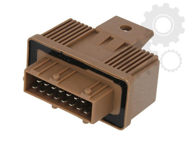

The relay I am trying to replace (once I have found it) is a 1920 7L - brown double relay - sold to me by my local Citroen dealer - it is listed on the Citroen Service website under Engine --> Air and Fuel Supply --> INJ CALCULATOR SENSOR --> item no 2
This is the relay Image
I am lead to believe that this is the Fuel Pump and ECU relay.
Thanks for any help you can give

wheeler wrote:C8's don't have double relays as such, the injection/fuel pump relay is an integral part of the under bonnet fusebox. You need to confirm if the ECU has all its power supplies & earths.
Is the relay I have shown not the correct one - it is listed on the Citroen parts list for the car VIN
As i said in an earlier post the injection/fuel pump relay is an integral part of the under bonnet fusebox thats probably why you cant find it. Did the parts department search for this part from your VIN??
