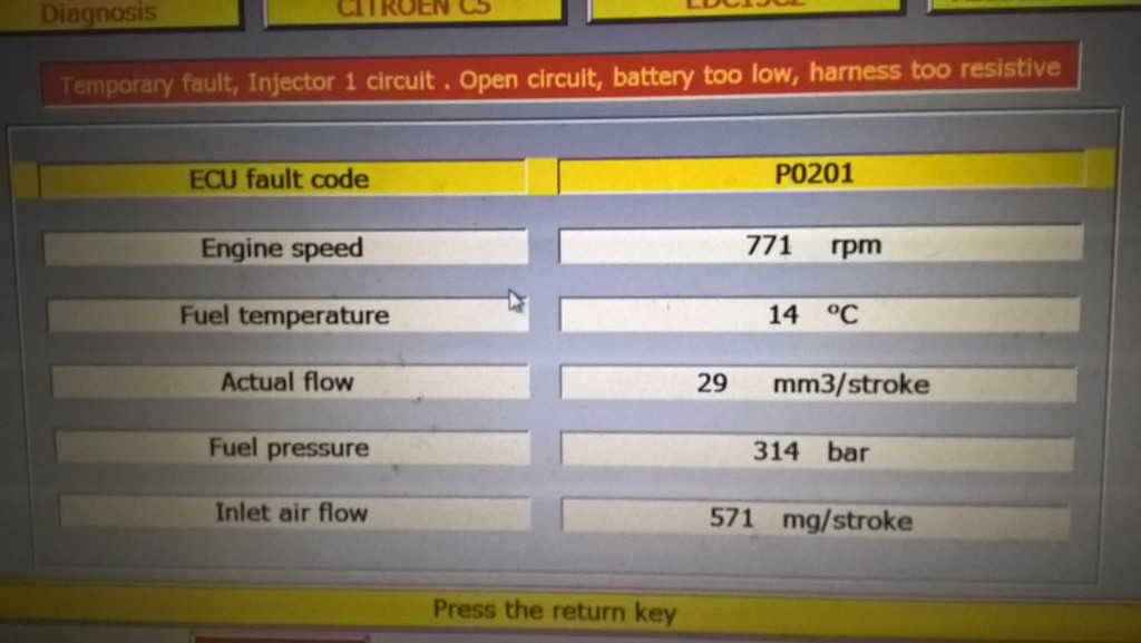

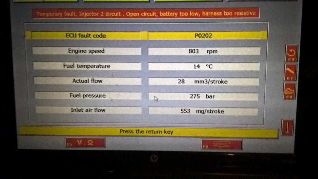

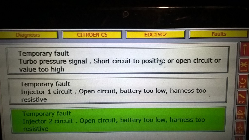

Dont take messages AS ACTUAL issues.. in other words the harness resistance could be an error caused by something else!

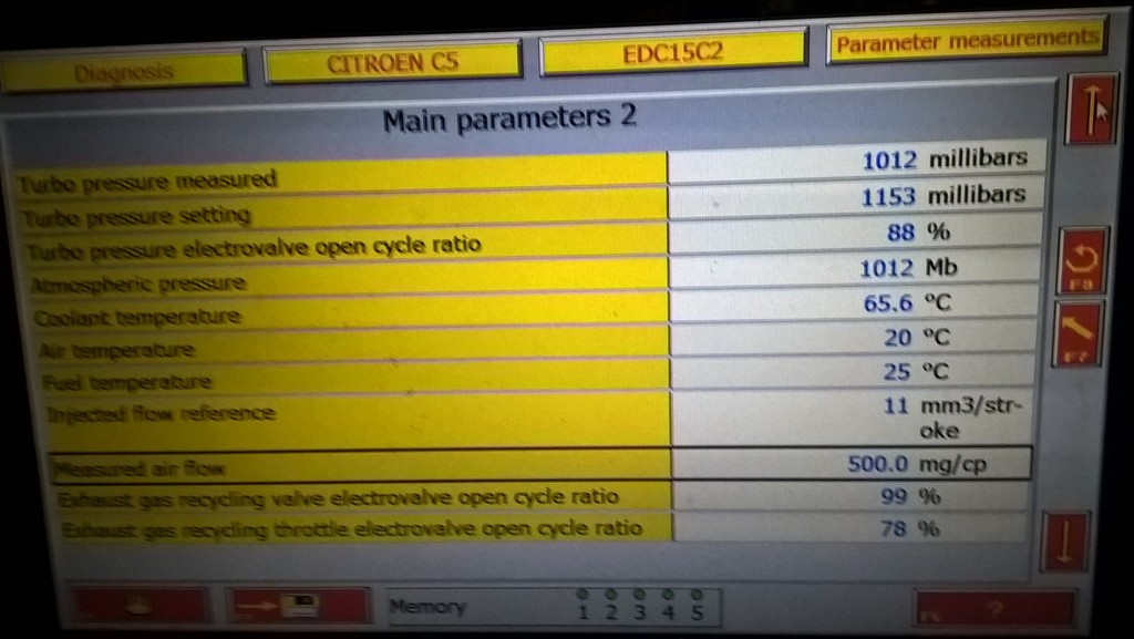

Firstly, does the car go into limp mode IE: Revs limited to 2.5 - 3k MAX ??

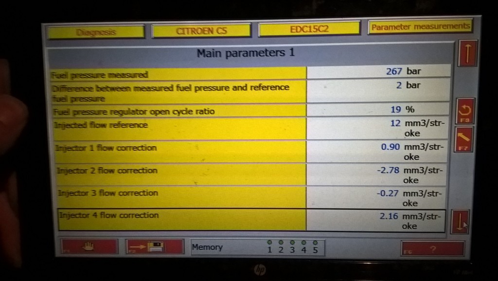

Those injector readings are all over the place!! Can you get your hands onto another set? Id say they were a bit all over the place and possibly causing your starting issue...

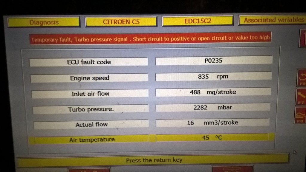

The Turbo pressure reading, reading high, that could be a faulty Wastegate control Electro Valve not shutting off and allowing over boost. Id try another electrovalve first. They are behind the passenger strut top, under the rear plastic cover.

I agree Paul re injectors.. my c5 had one that was all over the place.. upon changing it the car never failed to start again and never cut out dangerously at speed under load! we noticed that Pauls 2 injectors (2 and 4) were way off the correction of the other 2 (1 and 3)

The car never goes into limp mode and has lots of smooth power through the rev range.
It does look like the injectors are a possible problem, do you think any of the injector readings are OK and can stay?
