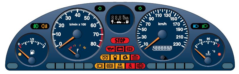

EDIT: I've found an image of a Synergie dash, it should look more or less like this:
Meaning, if the positions are correct, your blue sidelamp icon is actually the front fog lamp?

On my 1998 diesel SX, with foglights, the layout is:
No extra light for sidelights, the dashboard illumination comes on
To the right of the speedometer there is a pair of lights, green and blue, indicating dipped or main beam headlights and mutually exclusive.
To the left of the Rev counter there is a pair of lights, green and Amber, for the front and rear fog lights, both can be on together.
looking at an old French manual, if the vehicle does not have front fog lights one of the left hand pair is used to show sidelights on.
The oil level gauge which only registers accurately before you start the engine, is in the bottom of the Rev counter, with a symbol like an upturned J, with drips....
The centre display, shown in the picture from viborovic, has an exterior temperature indicator or a trip computer on later/better equipped versions.
