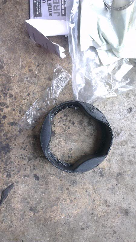

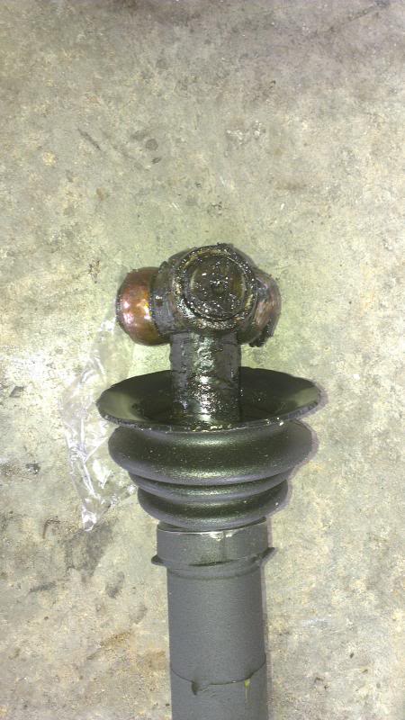

I wanted to replace my C5 (Year 2007 2.0L Petrol) driveshaft inner gaiter (The rubber cover). So I sent the picture of the worn rubber joint as attached to the dealer:

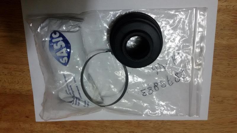

But the dealer given me something that is too small to fit:
The dealer assured me that this rubber cover is certainly meant for my model. Unless, I'm able to tell them the exact part number, they are unable to allow an exchange.

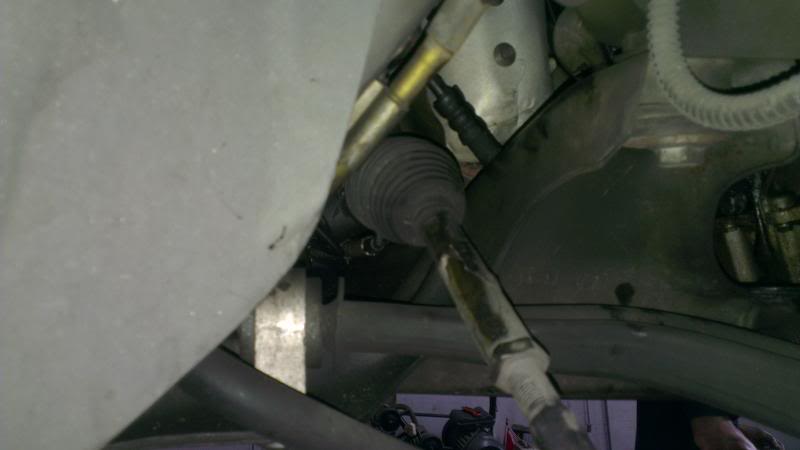

Are you sure that's a driveshaft?
One of the pictures shows it as the steering track rod.

I agree, the third photo shows a track rod. A drive shaft is a lot thicker.

Looks like the inner end of the drive shaft, that will be a different gaiter to the CV joint.
