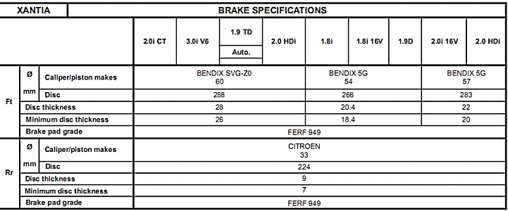

Here is a Xantia Brake Specifications chart. I hope it'll be helpful for other forum members (and guests) as well :) .
(rear disk size is same for all models, that's interesting)
Also 2.0 HDi is seen in both 288 and 283 #-o

VertVega wrote:...Also 2.0 HDi is seen in both 288 and 283 #-o...
IIRC that is because the HDi 90 uses 283mm and the HDi 110 the slightly larger 288mm.
