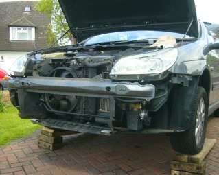

I've got a C5 with xenon headlights - and also a dud sidelight bulb on the driver's side. I've had a quick look but it seems impossible to get in there. Can somebody tell me that I don't have to remove the front bumper!!!

I take it that it's a mk2 ? It can be done with little hands but it is tight, try gently pulling in the wires once you twist the bulb holder.
Have you got or priced the bulbs yet ? i dont know if anyone else does them yet & they are over a fiver from Citroen :shock: for a tiny sidelight bulb.

It's a 5w bayonet but it has offset pins(if it's a mk2 that is), never seen these bulbs anywhere else yet.

Job done! But not till after the front bumper was removed. Cit dealer wanted £95 to replace the bulb and even charged me £6.82 for the bulb. Since completing the job I've found http://www.consumabulbs.com/files/bdet.php?id=170
do them at £3.95 incl. p&p.
It's bizarre that you have to resort to this to change a sidelight bulb!
