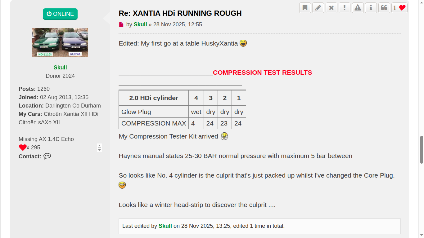

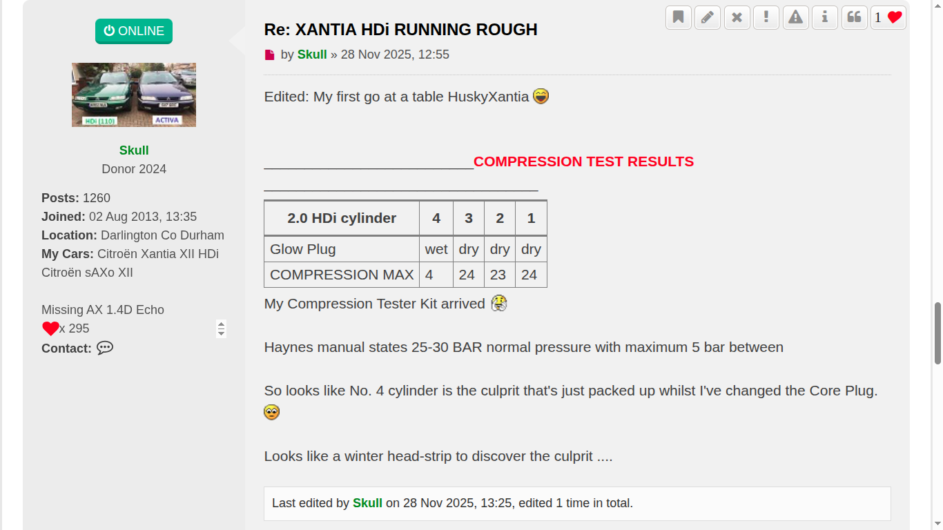

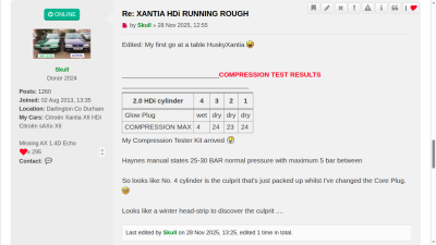

Edited: My first go at a table HuskyXantia :lol:
__________________________COMPRESSION TEST RESULTS __________________________________
2.0 HDi cylinder 4 3 2 1
Glow Plugwetdrydrydry
COMPRESSION MAX4242324
My Compression Tester Kit arrived =D>
Haynes manual states 25-30 BAR normal pressure with maximum 5 bar between.
Seeing as my test was done with a cold December engine I think we can say No.s 3-2-1 are healthy.
So looks like No. 4 cylinder is the culprit that's just packed up whilst I've changed the Core Plug. :roll:
Looks like a winter head-strip to discover the underlying issue ....whether she gets put back together will obviously be another matter :roll: ....

Unread post by Huskyxantia »
Im not seeing anything 😕
:-D
Posts: 28742
x 5674
Re: XANTIA HDi RUNNING ROUGH
Huskyxantia wrote: 28 Nov 2025, 13:13 Im not seeing anything 😕
Looks OK here:-

Huskyxantia I certainly hadn't noticed any white smoke prior to the Core Plug leaking, it's possible that the Head Gasket has litterally just let go at the same time and that extra pressure has finally blown through the corroded Core Plug, despite that it's not over pressurising the system now.
Still hard to believe that No. 4 was still running down at the MoT station, but has now stopped completely.
Gary
