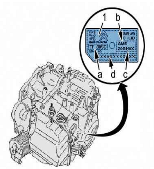

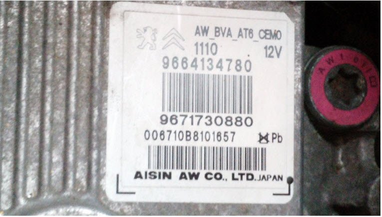

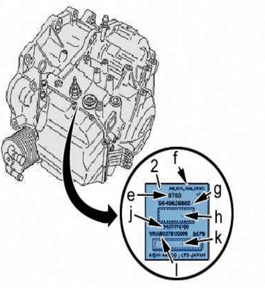

It seems this sticker is under the air filter house. Isn't it?
- x 6957
Re: Aisin Tf-80 / AM6 Oil Change Questions (Mini-Guide Page 4)
| The identification 'Plate' is riveted to the Gearbox casing here: |
| There is an identification label attached to the ECU here: |
