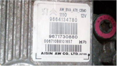

Barbrady - you are looking for markings like these
Labels on Gearbox AM6 (AW-1) fluid

There is an identification label attached to the ECU here:
  • "e" :Date of manufacture
  • "f": Homologation number (PSA)
  • "g": ECU no. (PSA)
  • "h": Bar code (PSA)
  • "j": Gearbox no. (PSA)
  • "k": Bar code (AISIN)
  • "l": Serial number
