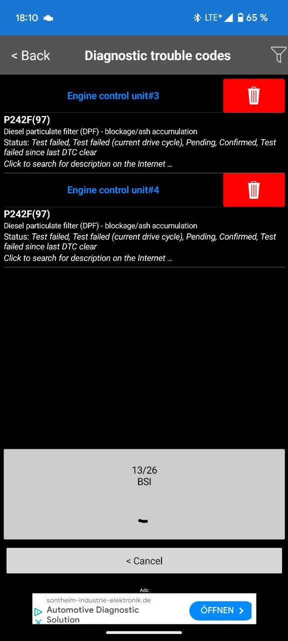

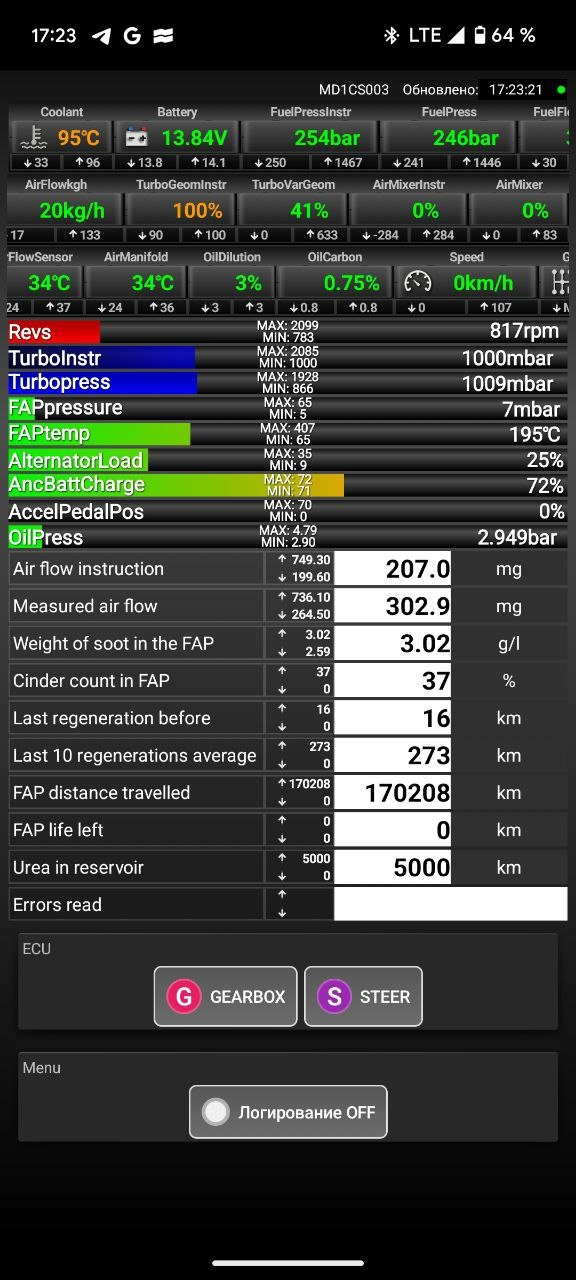

OBD scanner shows P242F(97) alarm, and FAP app shows FAP life left is 0 (together with very short regen intervals of ~300km).
Actual mileage is 170,200 km (I am in Germany).
All the rest is Ok - dynamic, fuel consumption, FAP differential pressure (as can be seen on screenshot), as well as cars cockpit doesn't indicate any alarm.
Well, ok, I am not sure about Cinder count in FAP = 37%, is it much?
I thought refilling Eolys helps me, but obviously I don't have it.
Should I worry about replacement of DPF now? Or, what should I worry about now? :D
Best regards, Ted

Yes, from that mileage your DPF is likely nearing / reached end of service life. The code means the filter has reached the threshold of it's service life, so time to think about either having the DPF professionally deep-cleaned or replaced with a new one and then telling it you have replaced int he repair section.

GiveMeABreak wrote: 05 Jul 2024, 18:39 Yes, from that mileage your DPF is likely nearing / reached end of service life. The code means the filter has reached the threshold of it's service life, so time to think about either having the DPF professionally deep-cleaned or replaced with a new one and then telling it you have replaced int he repair section.
May I know, what happened if I ignore this for a while?
I mean, it's looks to time kind of "statistical" interval from Citroen, when DPF must to be replaced.
I am thinking to monitor diff pressure, but the question is - can the car forcibly gone to limp mode just becasue of "calculated lifetime" is finished?

The system is fitted with differential pressure sensors that act as a safety device. You may need to go for a 'hard drive' on the autobahn to get the engine gasses nice and hot and give the DPF a good opportunity to regenerate the filter. But you have to realise that engine debris and ash (that can't be burned off during regeneration) will remain and gradually block the filter. If the filter gets anywhere from 70% and upwards blocked, then it may become impossible to regenerate and will need replacing.
You will eventually get power limitation (limp mode) initiated by the engine ECU if the filter remains blocked as this will cause back pressure and engine problems.

One last question - is "Cinder count in FAP" in FAP app shows the blockage of the filter? It's currently 37%.
I am wondering how can it be calculated by ECU...
